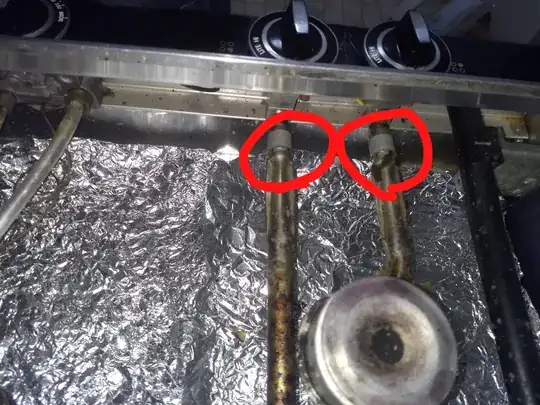

This is picture of my gas stove. There are two gas lines you can see, each controlled by knob and going to burner. Where I circled, there is a small slit , I am wondering what is that for ? Why wouldn't gas leak from there and catch flame ?enter image description here

The gas is mixed with air before going to the burner, the slit allows air to enter.
The gas does not leak from there becase there is a jet of gas causing a wind current blowing down the tube to the burner.
Jasen
  • 19,044
    Otherwise known as a venturi ; the flowing gas sucks in air. Without it the burner flame would be yellow/ orange and put soot on pans. – blacksmith37 Jan 18 '20 at 01:40
    @user2716454, think of a garden hose and a puddle ... if you spray water into a puddle at an angle, the water stream will drag the water in the puddle and empty the puddle ... the gas stream is like a water stream from the garden hose, it drags the surrounding air along – jsotola Jan 18 '20 at 02:25
