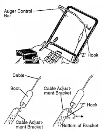

I was curious about this question and the comments suggesting the shear pin, so I entered the model number in a search engine that's usually been pretty Googd for finding things. If found a lot of links to scam downloads but not the manual. I went to another search engine that doesn't get as much play and Bingo it found the manual.
The manual does not mention a shear pin in the troubleshooting section under "Unit fails to discharge snow" and I did not see one in the exploded diagrams. So I think this snowblower may just depend upon the belt slipping when jammed.
The troubleshooting section only mentions clogs, the belt and the auger control cable.
Clogs are obvious, but an object jammed between the auger and the chute can be harder to see. But if the auger turns by pushing on it with a stick when off, you know it's not jammed.
If the belt is tensioned properly it's possible the belt got glazed, that is, when it was loose and slipping, its surface got polished and with less friction, it can no longer transfer much torque.
The auger control cable is my bet, make sure it's doing it's job, they do tend to slacken with vibration. If you can make the auger turn by pulling the cable with a pliers (carefully) it's not tensioned properly.
Craftsman-536.884581-augerControlAdjustment
batsplatsterson
  • 24,954
    Thanks batsplatsterson!!! I conducted an additional test by “turning the auger after securing the auger control bar to the handle and the auger did turn. To further validate your theory, I changed the cable position in the “cable adjustment bracket” to the tightest level and could still rotate the auger relatively easily. Hence you are QUITE CORRECT that the belt is not tensioned properly. I’ll purchase and install a new belt (319596) as I agree with you that the belt is the root-cause!! However, I’ll have to wait until the next snowfall to confirm! – user97485 Jan 26 '20 at 15:59
