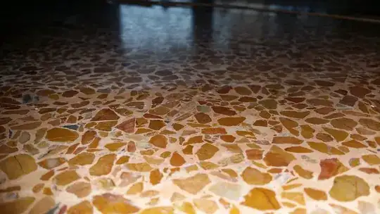

I have a mosaic floor which caught mold from rotten food some time ago. Here is the floor which is ok (with and without flash). enter image description here enter image description here
And here is the damaged floor after the "polishing". I tried to do with diamond polishing pads of grits 400,800. enter image description here enter image description here enter image description here
As you can see the result is no good. The polish is insufficient. Even the bulk imperfections and discoloration from the mold damage haven't been taken out although I have polished thoroughly with good pressure. Should I have tried lower grit than 400,or bring a professional to do the whole room?(I'm trying to do only the part which got damaged)

Your first mistake was using the diamond pads. Part of the discoloration is stone dust being embedded in the concrete filler. You had a mold problem or staining from food/drinks being spilled. You should have started out with a non abrasive concrete / grout cleaner. You could have even used a mixture of beach and water. Try doing this and just work on the cement/grout filling. Once that's cleaned up use a buffing pad and polish on the affected stones.

  • I did try mopping with bleach before using the diamond pads but nothing happened. Also had tried vinegar. Maybe should have used a brush? I will get a grout cleaner and try. Shall i use Brasso or plastic polish with the buffing wheel? – Alekos Reps Jan 27 '20 at 10:37
