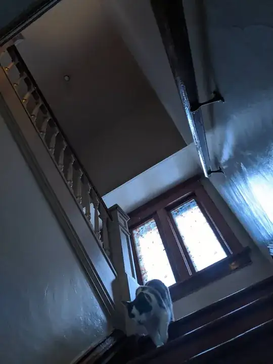

In my 1911 home, there is a stairwell that has a 180 degree turn with a landing, and there is a light fixture directly overhead (centered over the railing) that I would like to replace with a pendant light. When I'm standing directly below it (halfway up the second flight of steps) the ceiling is about 3 feet out of my reach. I imagine there is some standard approach to doing this type of work (someone installed that light in the 1950's).
How can I get a stable ladder or platform in place to safely work on that fixture?
The second story ceiling is 8 feet 6 inches above the floor, as shown in this photo:
View of fixture from second floor
On the other side of the railing, the distance from the fixture to the closest step on the first flight is about 15 feet:
View of fixture from first floor (cat for scale)

    There are ladders that work great in stairwells adjustable A-frame type. Gorilla and little giant are two popular brands. – Kris Feb 06 '20 at 22:44
  • the builders probably used a scaffold – Jasen Feb 07 '20 at 03:21

  • Here's what I would do: 1) Look at scaffold rental. Decide life's too short. 2) Get quotes from electricians to do it. Decide I'd rather use the money for a vacation. 3) Leave the old fixture there. – jay613 Apr 17 '21 at 15:33
You can try this type of ladder. It allows for a configuration like this on a staircase:
ladder

    These ladders are good for some staircases, but the one in the picture looks like the ceiling is just too high. OP can take some measurements to be sure. – JPhi1618 Feb 07 '20 at 15:13
    If you’re only 3 vertical feet off while on the stairs, the right staircase ladder should easily give you that 3 or 4 foot rise you need. – v15 Feb 08 '20 at 17:50
  • @v15 I think you're right, I'm considering buying one of these now. – Parker Feb 10 '20 at 22:56
  • @vallismortis I think you’ll be pleasantly surprised at how well it works for a set up like that since you can control how steep of a pitch (angle against the stairs) you’re comfortable working with. – v15 Feb 11 '20 at 03:45
