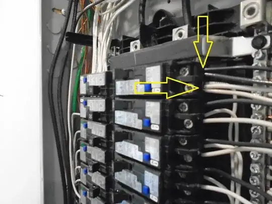

I am puzzled by a "double-lugging" of a CAFCI, made by Siemens on a newer residential construction. Work is done by a professional electrical contractor, in Southern California.
Does Siemens allows CAFCI to be double-lugged?

  • Is it the fuzzy photo or are there _three_ neutrals on that breaker? – isherwood Feb 09 '20 at 19:47
  • Notice how all the wires are runted off to *only, barely* make it to their present breaker. No way to move anything around in this panel! @isherwood You do indeed see 3 neutrals, and 2 on all the other breakers. Those are the AFCI pigtails. – Harper - Reinstate Monica Feb 09 '20 at 19:56

Siemens QP breakers, with basically no exceptions, cannot be double-lugged the way you see there. Fortunately, this is easy to fix. All you will need is a couple of 12AWG stranded THHN pigtails (one black, one white) and a pair of wirenuts suitable for 3 12AWG wires each, as well as an inch-pound torque screwdriver to set the torque on the breaker lugs properly. Turn the breaker in question off, unfasten the wires from the lugs, nut each pair (black and black, white and white) together with its corresponding pigtail color, insert the pigtails into the correct lugs (black in the top lug, white in the bottom lug), and torque the lugs back down to the labeled torque values using your torque screwdriver.

The crux of your question is covered in this question. Looks to me "no"; The breaker isn't labeled for double lugging, and neither is the panel. However I see other work here that concerns me.
The panel is much too small. It's a 30-space panel and 31 spaces are already used (hence the double-tap). I have a feeling the AFCIs are new, but the panel is an old installation, and the electrician "saved you the money" of tearing up the wall a bit to install a 40-space panel. The old panel worked because of use of double-stuff breakers.
Some circuits shouldn't be on AFCI or GFCI (e.g. refrigerators), so if you can find 2 such circuits, you can convert them to a double-stuff breaker and free up a space so those 2 circuits can each have their own AFCI breaker. All AFCIs seems a little crazy, given the overstuffing of this panel.
Another option would be a sub-sub-panel fed from here, possibly in a different location. Stay with Siemens, so you can reuse those $40-each breakers.
Lastly, the electrician did the "neat-freak" thing of runting down all your wires so they only have just enough length to reach the breakers they're in now. That limits your ability to rearrange breakers for logic, or to make space for added features like generator interlocks or surge suppression. This panel would be super easy to add a gen interlock to if you ever wanted to.
