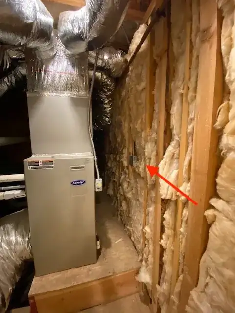

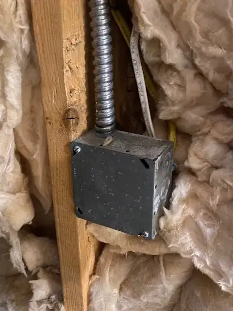

So I'm now thinking of putting a UPS battery system indoors. Behind the water heater is a crawl space. The AC power for water heater comes from a junction box inside this crawl space (see photo below). The white Romex cable is what goes outside and supplies power to the tankless heater. The yellow cable is the power supply. The metal conduit goes to the HVAC unit.
Instead of white Romex cable going into this junction box, can I create a power inlet like this next to the junction box, and terminate the white cable there? I will also create a new power outlet from the junction box. I will buy a pure since wave UPS like this, and plug it into the AC outlet. And then I will use an extension cord to connect the UPS to the inlet.
To summarize, electricity flows from the junction box --> new AC outlet I'm creating --> UPS backup battery --> white Romex cable --> water heater outside.

  • Can you unmount the switch and get us another photo of the inside of the box please? – ThreePhaseEel Feb 10 '20 at 00:47
