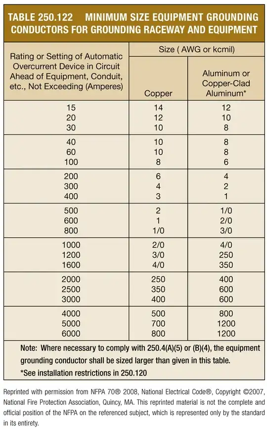

-1
#10 then is only good for 30 amps , correct this before too many people see this
As requested, correcting this: using the chart from https://diy.stackexchange.com/a/151175/18078
  • This does not provide an answer to the question. Once you have sufficient [reputation](https://diy.stackexchange.com/help/whats-reputation) you will be able to [comment on any post](https://diy.stackexchange.com/help/privileges/comment); instead, [provide answers that don't require clarification from the asker](https://meta.stackexchange.com/questions/214173/why-do-i-need-50-reputation-to-comment-what-can-i-do-instead). - [From Review](/review/late-answers/160319) – Rohit Gupta May 03 '23 at 19:40
    You are incorrect, and the question is more than 2 years old. But mostly, you're incorrect about the specific case of sizing of grounding conductors, which is the question here. – Ecnerwal May 03 '23 at 19:49
