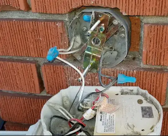

Update: here are is the type of wire that was used by the previous owner AND a close up of the point where the cable enters the wall to feed the first light and then it exits to go up and head over to the second light. I rotated the image so you can read the wire specs, in fact the right side is the bottom of the image
My intention is to install a power outlet just below that hole I might want to add a switch to shut off the lights when the in house switch is on so I can work with the table saw without having the lights on during the day time.
Update: Here is a picture of the box behind the first light (the one to the left). The black (hot) wire seems to have a cracked insulation just where it exits the wall, I had to put some tape there enter image description here

  • Have you looked at the insides of the boxes involved to verify that a ground wire is present? Your NMD-90 may predate the requirement for a ground wire... – ThreePhaseEel Feb 20 '20 at 02:52
  • Right now is bitter cold (and dark) around here, probably I will try to have a look tomorrow. I don't know if there are any boxes on the garage light circuit. If there are any they must be covered by ceiling and I have no access to them. I posted about the next step here https://diy.stackexchange.com/questions/185139/what-would-be-the-wiring-diagram-to-add-a-receptacle-switch-combo-to-the-outdoor/185142#185142 BTW everything in the house seems to be wired with grounding – MiniMe Feb 20 '20 at 03:50
  • I just updated the question with a picture taken today, I almost lost my fingers with this cold and the metal of the light was even colder. Plus that I had to tape the hot wire which has the insulation cracked – MiniMe Feb 20 '20 at 22:08
