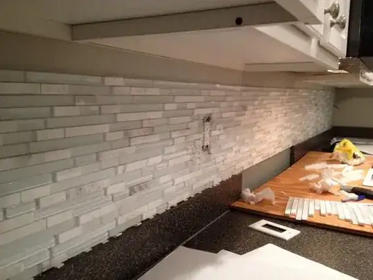

I recently put up a tile backsplash with mosaic marble and glass tiles. I'm preparing to apply sealer to the stone before I start grouting. It's several hundred 1/2" x 2" to 7" mixed in a random pattern. Here's a photo:
The tiles
It's going to be nearly impossible to avoid all the glass tiles, but both the sealer and tile instructions clearly state to keep sealer away from glass - any tips on how I can apply this to the stone tiles without mucking up the glass? Alternatively, are there any stone sealer products out there that don't have the glass restriction?

  • What product? Glass is nonporous, never heard of this issue. – Gunner Oct 02 '12 at 01:51
  • I stated that poorly. Our sealer (Sealer's Choice Gold) says it should not be allowed in contact with "non-recommended" materials, which is anything besides stone or grout. Our tiles came with install/maintenance instructions that state that sealer should only be applied to the stone tiles, avoiding the glass. – Surreal Dreams Oct 02 '12 at 02:15
  • Ouch. Maybe you can mask off all the glass with masking tape? Or take an off cut and put the sealer on the glass and see what happens. Maybe nothing? I would give it 24hours and see if any discolouration occurs. If not then apply it and generously clean the glass after 24hours with methylated spirits. Either way. It is allot of monkey work.I doubt it will make the glass explode/implode/shrink/grow or shatter. It might just colour it at worst. – Piotr Kula Oct 02 '12 at 12:45

Alternative idea.
Test the sealer on a piece of left over tile.
Let the sealer get onto the glass and wipe it up shortly thereafter.
Compare the before/after -- if you see no notable damage, just put the stuff on and have someone clean up the glass right behind you.

    About to write up the same thing myself. A little one the job experiment with scrap is always a good thing. You gain expert knowledge of what actually happens (as opposed to what should happen). – Edwin Buck Oct 02 '12 at 14:58
    We ended up testing the tiles (no damage, even after sitting 24 hours) *and* using artist brushes. Thanks for your suggestions. – Surreal Dreams Oct 07 '12 at 15:30
Since you're going to be doing delicate work, it calls for delicate application.
Use artists brushes.
Flat brush for the marble:
Filbert brush for the grout:
It'll be slow but it'll be precise.
