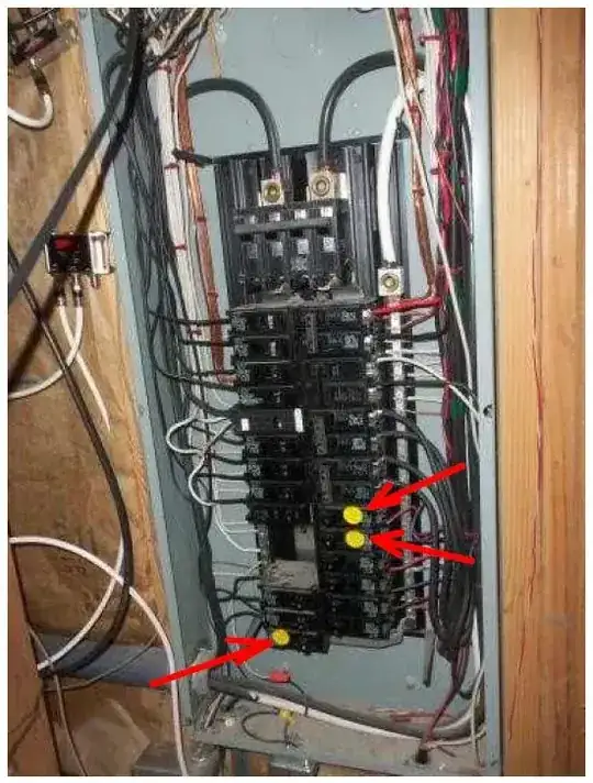

Per request in the comments, I've added an image of the breaker panel open: Breaker panel open Breaker panel without zoom
(without the zoom of the above picture)
Note: Ignore the yellow stickers / red arrows. This image is from my initial home inspection which was pointing out some issues with oversized breakers. Those issues are resolved and I assume they don't affect these outlets. Sorry about the image quality, the original image was not very high res.

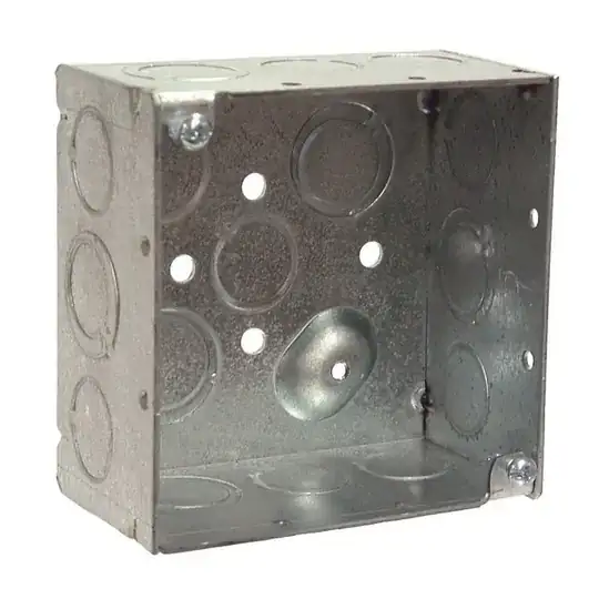

Inside the outlet box:
I apologize, but this is as close to disassembling the outlet as I'm comfortable with. I understand if your first impression is "those pictures are worthless", but I figured I'd post them in the event that they help in any way.
Overview of Outlet Box Overall view of the outlet with the box opened.
Top of Outlet Box Close up of the top of the outlet box.
Bottom of Outlet Box Close up of the bottom of the outlet box.

    Can you turn the breaker powering it off, open up the outlet box, and post photos of the wiring inside it? – ThreePhaseEel Mar 01 '20 at 14:45

  • @ThreePhaseEel - I know this is over a year late, but I've added some additional images of inside my electrical panel and some images inside of the outlet box per your request. Not sure if they help given their quality, but figured I should follow up; better late than never. – William Apr 09 '21 at 02:16

That recep appears to be right next to your service panel, connected to the panel by a 1" conduit nipple.
That makes it the "magic electrician's outlet".
It's not required by Code. It's just a "common practice" for an electrician to fit such an outlet, and place it on a dedicated circuit breaker. This costs about $10 normally ($5 for the breaker, $1 for the nipple, $1 for the Handy Box, and $3 for a quality recfep and cover). This is generally the first breaker installed in the panel. The electrician then runs extension cords off it to power tools and lights while wiring the rest of the house. Alternately, the electrician can power down the whole house (except that one circuit) and do the needed tasks.
Since it is dog simple, only the two THHN wires to the recep (ground is via the steel conduit itself), it's very easy for the electrician to visually inspect that it cannot possibly be interacting with any other circuit in the house. So the electrician can be confident that the entire house is powered down.
I'm not sure why your electrician would use an orange one. I would look closely at how it is grounded to the ground screw on the receptacle. Perhaps the electrician wired it intentionally groundless for some reason, in which case I would hope and expect to see it fed from a GFCI breaker.

  • And you are correct, these are directly feeding off of the breaker panel / service panel. The smooth grey colored thing with beveled edge and the flat head screw going into it is my breaker box. I thought I mentioned that in my original post but did not; but that's a crucial detail I left out. – William Mar 02 '20 at 01:26
    It means JACK caught something I missed. I got derailed by orange meaning hospital grade. You could stick a magic 8-ball 3-lamp tester in there and see if you get 2 happy lights. You could also see if the breaker that turns it off is a GFCI breaker. (By convention they typically put that breaker on the bottom right or botton left). – Harper - Reinstate Monica Mar 02 '20 at 01:26
