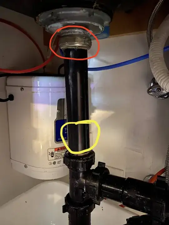

This pipe under my kitchen sink has a big crack in the area circled in yellow. (It's on the back side so it isn't visible in the photo.) Can I simply unscrew the nut at the top that I circled in red to replace the pipe? I'm afraid to just go ahead and try in the fear that I will put my kitchen sink out of commission. I'm already ok with disconnecting the hand-tightened nut at the bottom.
my broken pipe
Update:
Success! I replaced the tailpiece with no problem. Thanks to all for the help.

Yes - that's a "tailpiece" - the new one may be too long, if so, they are made that way so you can cut them to fit - but there's also considerable space to slide them built into the connections, so don't overdo cutting them down.
    Wrap the cracked tailpiece with some electrical tape until you have time to fix it. It'll save you from having to empty the bucket + – JACK Mar 02 '20 at 00:30
    Parafilm® is nice for that if you happen to have any (former lab rat.) – Ecnerwal Mar 02 '20 at 00:35
    Since the drain is non-pressurized, the tape would be more than sufficient to redirect the water to the outflow. Just don't leave that as permanent solution because it'll eventually fail and the crack will also slowly get worse anyways. – Nelson Mar 02 '20 at 02:44

  • If he leaves the tailpiece too long it will block the outflow from the right-hand sink. – David42 Mar 02 '20 at 18:54
    @David42 There are "stops" in the tee to prevent that from happening. – JACK Mar 02 '20 at 20:15
