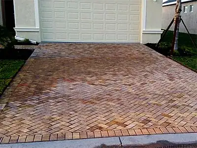

    From the question: "I have a huge surplus of reclaimed bricks". Ain't anything cheaper than that. – Martha Mar 04 '20 at 20:45
    @Martha - opportunity cost. Those bricks probably have a lot of value. These pavers are probably 50 cents a piece. – DMoore Mar 04 '20 at 20:47
    @DMoore, depending on the driveway or other use, pavers can add up quickly. The photo you show probably has +$500 worth of pavers in it, not including the sidewalk. If I can save that much on a project by reusing something, I sure will. – computercarguy Mar 04 '20 at 21:56
    I estimate that driveway used upwards of 1500 pavers. That's $750, not counting the sidewalk. – Martha Mar 04 '20 at 22:09

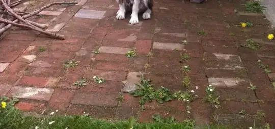

I've done exactly this - had an old retaining wall knocked flat by an earthquake in 2010, and used the red bricks to lay a patio. It worked nicely, but was not particularly resistant to moss and "green stuff" growing.
These bricks date from around 1926.
If you do this, expect to power-wash it twice a year, and that the green can be incredibly slippery in the damp.
To mitigate, I'd suggest cleaning and dunking each brick in silicon sealant completely, and letting it dry/cure before you lay them.
initial laying
after about 3 years, and its due for another power wash.
