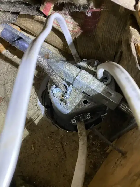

  2. I have two ceiling fans that have pretty large gaps between the box and drywall. This seems too large for foam without getting foam into the box. I was thinking of just using recessed light cover. Is there a better idea?

Filling the gaps around the junction boxes can be solved with the low expansion foam or just by stuffing some extra insulation in there before the final layer is put it. A picture from the other side of that opening in the attic would help.

  • Do the additional photos help? I can get a better photo tomorrow along the gutter and roofline if that helps too. – junta Mar 10 '20 at 00:56

For the can lights, I think you're supposed to build a box around them so they have air space around them and aren't packed into the insulation. They look old -- I think there are newer ones that are ok with being surrounded with insulation...and maybe if you use LED lights, they wouldn't heat up too much.
