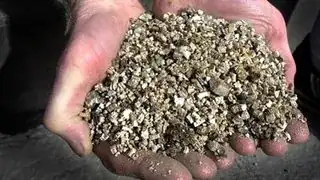

I think linatics is correct in that it's probably not asbestos, however you really can't tell just by looking at it. There are some materials (vermiculate insulation being the most well known) that were known to be contaminated in some cases - so even though it was not asbestos, depending on where it came from, it might actually contain it.
If you are unsure, the safest thing to do is have it tested and treat it as contaminated until you find out otherwise. This means not disturbing it other than to take a sample, and make sure you wear a respirator when you do.
