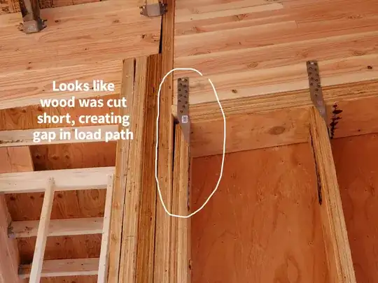

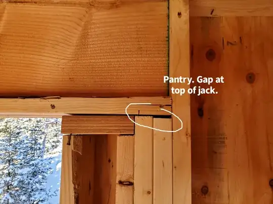

I recently hired a framing crew to frame a new house. After it was done, I commissioned an independent review. The reviewer described some of the work as "shoddy," and pointed out a lot of gaps, particularly between king and jack studs and the plates. I took photos and added his notes to a few studs he pointed out. He also pointed out that the roof beams weren't birdstoothed, as the plans directed, but were instead set onto the headers and strapped to scrap lumber. In one place, the beams are strapped to a split 2x4.
Would it be appropriate to ask the framers to fix some of this work? I don't work in construction, but even as someone outside of the industry I'm looking at this and it just doesn't look good.

    That's a lot of shoddy work. I would like to note that the glulam header and beam should not be notched unless the engineering indicated so. In other words, the framer shouldn't be the one deciding how that connection is made. – Dustin Wyatt Mar 08 '20 at 16:21

  1. In Picture #1 you’ve noted the gap issue, but missed the “double spliced sole plate”. (Splices are to be a minimum of 4’ apart, unless at intersection of a wall.)
  2. In Picture #1 it’s difficult to see, but the subfloor is not nailed properly. (Nailing should be a maximum of 12” apart in the field and 6”” apart at the edges.)
  3. In Picture #2 a twist strap is not an acceptable connector when it’s improperly nailed into a piece of blocking. (The length of the nails need to be long enough to penetrate into the beam...going through the piece of blocking reduces it too much.)
  4. In Picture #2 I don’t understand your comment about the “pocket”, but if the beam requires two trimmers then it needs a connector too. (That whole assembly is questionable.)

  6. In Picture #4 the framing to too “wonky” to be acceptable, including the gap you indicate at the top of the double jack studs. If the contractor argues that there are other jack studs next to them “so it doesn’t matter”. Let them know that the load is transferred to the foundation at the double jacks...not at random locations.

It's probably a good time to review the contract you entered with the framers. Does it allow you to withhold payment until defects are resolved? Does it stipulate how claimed defects are to be resolved? Do what the contract requires of you to ensure that you don't end up in breach too.
There appears to be a pattern of careless work and failure to abide the requirements of the project documents. It's going to be ugly to fix, but if you want to have it fixed, now is the time. If you allow construction to proceed then any work done by other trades which has to be re-done on account of the framing defects may be at your cost, not that of the framers.

From what I see in your pictures after a very quick precursory review, it appears that some of these items do not meet code and do need to be addressed (for examples: inadequately installed uplift straps; excessive gaps). Re the gaps, in the best case, there will likely be settlement of structure until full contact which will result in aesthetic issues.

Any gap under the king stud or anywhere in framing is a result of the framer doing crappy work, because everything in framing has to be on the line and flush and tight. If it's not then the house will shrink and creak, and drywall will crack.

At the minimum all gaps need to be filled underneath With a piece of lath or piece of plywood as long as its solid underneath the entire width and langth of the beam or king stud or cripple its sitting on . it will pass structural if those are filled and prevent sagging in the future hurrrican strap should have been nailed to a 2ft piece of 2x10 and 2x10 nailed minimum 18 3" nails Door Jack's are not a big deal but you could add one beside it and nail them to existing once So its solid.
