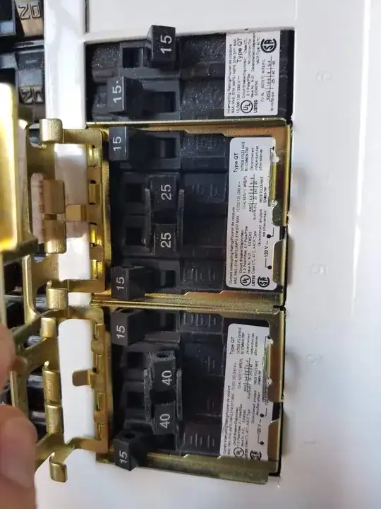

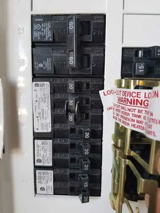

EDIT: Here are photos of the breakers in the manufactured home panel. Labels showing the circuits circuits circuits

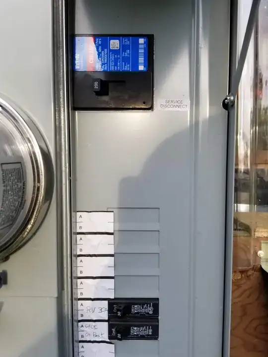

EDIT3: Here's 2 new photos of the 200A outdoor panel with the 20A and 30A circuits in it. outdoor label outdoor breakers
  • That Siemens panel is a 20-space. Very small. If you can get that changed, you'll want to. – Harper - Reinstate Monica Mar 12 '20 at 08:13
  • Huh I thought 20spaces was standard. It comes from the factory with electric furnace, washer, dryer, WH, range, dishwasher, fridge and microwave and that uses 11 spaces. 9 free. – Martin Vandepas Mar 12 '20 at 19:24
  • That's 12 spaces worth of stuff and you haven't mentioned the various recep and lighting circuits. The only way that all fits in 11 spaces is [double-stuff breakers](https://diy.stackexchange.com/q/110151/47125). Those don't come in AFCI, which need full spaces. That's what makes 20-space panels untenable since 2014 NEC. It's worse for 2017 and much worse for 2020. – Harper - Reinstate Monica Mar 12 '20 at 22:05
  • You might want to ask a question about that; shoot a pic of your panel with labeling saying what is what, and mention what state you're in. I'd rather you know *before* the inspector shows up. – Harper - Reinstate Monica Mar 12 '20 at 22:12
    @Harper HUD labelled manufactured housing are still subject to 2005 NEC per CFR Title 24 Part 3280.801. Arc faults not required. https://www.govinfo.gov/content/pkg/CFR-2019-title24-vol5/xml/CFR-2019-title24-vol5.xml – NoSparksPlease Mar 12 '20 at 22:45
  • I see, Yes they are mostly double stuff breakers and I don't see any AFCIs in there. I have a photo of a completed home's panel and there are indeed 9 free spaces. Thanks for the heads up. Considering AFCIs are not required, is the panel size still a concern? – Martin Vandepas Mar 13 '20 at 05:10

  • @MartinVandepas -- yes, that answers the HUD questions, but can you post a photo of the labeling on your MBE2040B200BTS? I suspect you may have painted yourself into a bit of a corner here trying to pull 200A out of that thing... – ThreePhaseEel Mar 14 '20 at 05:11
  • @ThreePhaseEel I added some photos of the outdoor panel. – Martin Vandepas Mar 14 '20 at 15:37

Good news: you didn't paint yourself into the corner I originally feared
When you originally asked about service equipment, my prime concern was that you simply couldn't get a 200A breaker or subfeed lug block to fit in the panel you had originally selected; however, that appears to not be a major concern for this panel, as it is labeled to accept the BRS(F)225 subfeed lug kit as well as the type BJ breaker, which is the double-frame version of the type BR used for loads up to 225A.
As a result, your plan with the BRS(F)225 subfeed lug block is acceptable, especially considering you'll be putting a disconnect on the outside of the house in any case. Also, the use of tri-rated MHF cable here is fine; the tri-rating (RHH/RHW-2/USE-2) allows it to be freely run within conduit in addition to permitting direct burial usage, and the fact it's an unjacketed multiplex cable means that it doesn't hog fill the way a jacketed cable does. This is set out in Chapter 9, Note 9:

I would not concern myself with the additional loads in the outdoor panel beyond running a load calculation to make sure you aren't overloading the service if someone plugs a RV in while the house is wired up. Moving them to the indoor panel is just a silly waste of wire, if you ask me, and their current location is permitted by NEC 550.32(E):
(E) Additional Receptacles. Additional receptacles shall be permitted for connection of electrical equipment located outside the mobile home, and all such 125-volt, single-phase, 15- and 20-ampere receptacles shall be protected by a listed ground-fault circuit interrupter.
