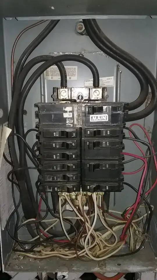

EDIT: Here is a photo of one of the labels. enter image description here

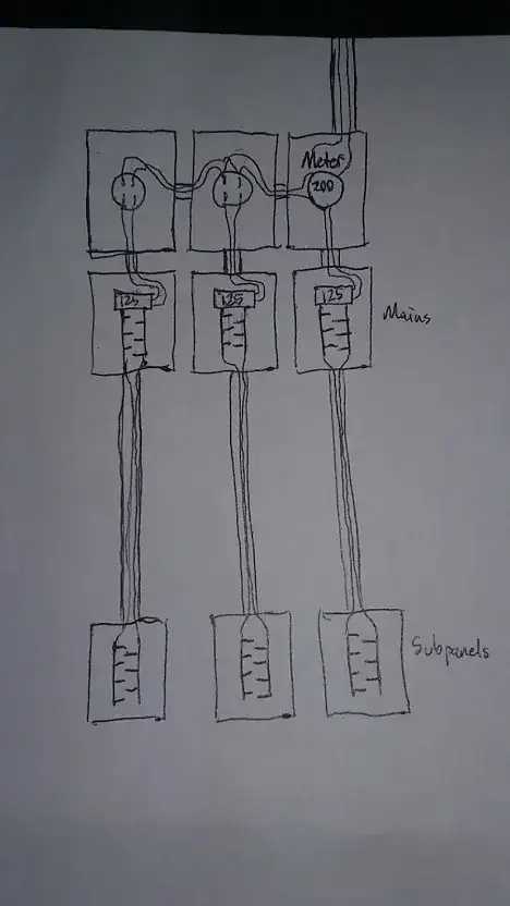

EDIT: Here is a sketch of the layout of the system. Note that I have omitted the neutrals and grounds for simplicity's sake. The subpanels are also not located anywhere near the meter boxes and mains; they are included for explanation purposes. I was also unable to provide a photo of the entire setup due to the fact that I am away from this location at the present time. enter image description here

  • @Sagierian -- one more thing: can you post a close-up (with the main breaker off) of one of the labels on the inside right-hand side of the main panels? – ThreePhaseEel Mar 22 '20 at 14:15

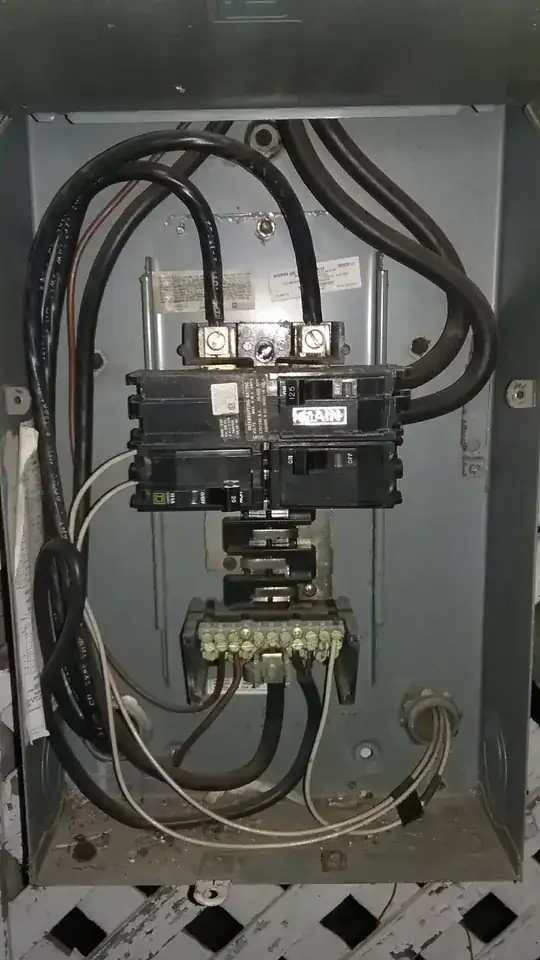

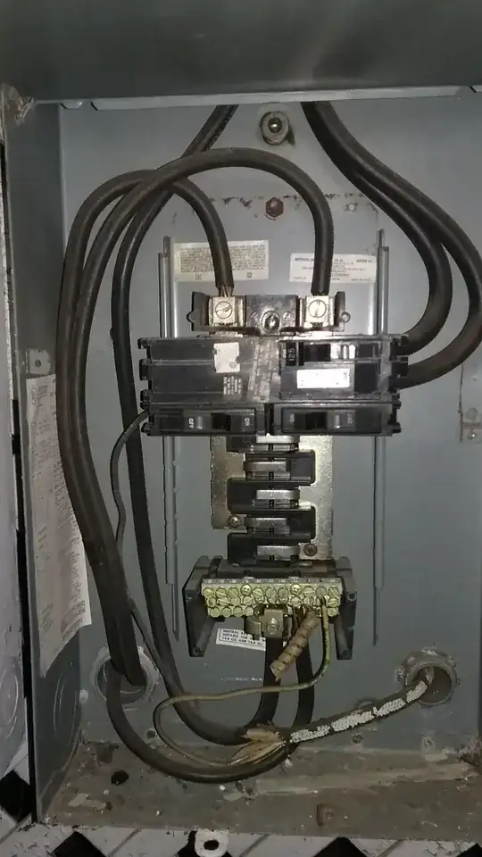

    @Sagierian also, can you get us some photos of the overall setup of the metering equipment please, or a sketch of the physical layout of the metering equipment and main panels for that matter? – ThreePhaseEel Mar 24 '20 at 04:10

  • @ThreePhaseEel - I have posted a sketch of the system above. Note that I am unable to provide photos at the moment as I am away from this location (it is actually located very far from where I live) and probably won't be back for a month or so. If you have any questions about it please let me know. – Sagierian Mar 24 '20 at 04:19
