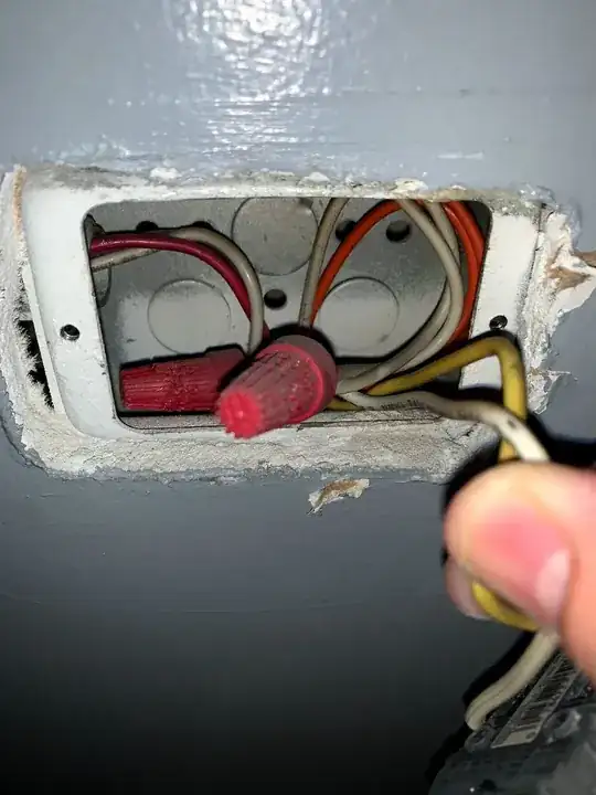

I'm working on upgrading the kitchen and wanted to add a garbage disposal. Currently there is an outlet under the sink were the DW is hardwired to, can I add an outlet by splicing off the feed and secure the cables with some wire nuts and create a new outlet for the garbage disposal adjacent to the dishwashers hardwired splice box?
I've included what the wiring looks like in both the DW splice box, and the outlet opposite to the sink.
Should I just disconnect the DW and make an outlet for both using the same supply line?
The other option is there is an outlet on the wall opposite to the sink that I can maybe splice off, but I think it feeds the Dishwasher at the current time so I don't know if it will make a difference?
I appreciate any suggestions you guys might have
Dishwasher-disposal "outlet box"
Dishwasher "outlet box", one of the flexible metal conduits feeds to the DW, the other goes to supply
The two red and brown wires go to the switch+fuse you see in the first photo, and that disconnects the dishwasher. Can I just replace this with dual 20A GFCI outlets for the dishwasher and garbage disposal?
Below, this is the receptacle in the plug opposite to the sink. My concern is, can this handle adding another splice of wires for a new outlet dedicated to the garbage disposal?

  • I just did a major edit to my answer to accommodate the fact that you *do* need a receptacle, because of the way you plan to switch the garbage disposal. I also found a cheaper way to add GFCI. It will involve some trivial pipe work, but won't disrupt the equipment protecting your dishwasher. – Harper - Reinstate Monica Mar 18 '20 at 21:45
If the undersink cabinet has a door, you don't need GFCI as of 2017 in letter. That from the horse's mouth. You also don't need it in spirit if the appliances are hardwired and grounded.
Here's what I see.
Dishwashers are a heavy draw because they heat water or dishes (to dry them). As such, the dishwasher takes more than 50% of circuit capacity and cannot be on the same circuit with any receptacles.
Further, the dishwasher and disposal require more than 20A of power to be provisioned to them, so they cannot share a 20A circuit. Fortunately, the builder thoughtfully provided an MWBC.
Option 1 is a Code win; if GFCIs are required option 1A or 1B win. The rest have issues.
Don't sweat the lack of grounds; it's carried in the metal conduit*. Also, don't sweat weird wire colors because Toto, we're not in cables anymore. This is conduit where we get to use colors freely to distinguish circuits and functions. Grounds are green, neutrals are white or grey, and everything else is hot. No remarking.
It is clear that your locality has high wiring standards. Note a) the EMT conduit (at far back of big-view image, b) armored conduit or wire whips to the dishwasher, c) swerving out of their way to place the box right there, and d) the expensive hoozit-we-don't-know-what-that-is. (it's a disconnect switch and a fuse). This indicates that local Code amendments set a high standard. No answer should ignore or armwave this. Things are so well grounded that I don't honestly see a need for GFCI. Ground > GFCI in hardwired stuff like this.
The right pipe goes to the dishwasher. The left pipe comes from supply, and has 2 hot wires and 1 neutral. Further, since this 4x4 box is surface mounted and we can see all the back-face knockouts are intact, so the purple wire definitely does not exit the box: it stops right here. Why?
Now it's exceedingly common to place both dishwasher and disposal on a Multi-wire branch circuit (MWBC). That is 2 hots and a neutral on opposite poles, sharing a neutral. That provides effectively a dedicated circuit for each appliance. Without a doubt, that is what we're looking at: the bog-standard MWBC for dishwasher/disposal. They threw the purple wire in the pipe because it was easy (another class act).
Normally dishwasher/disposal MWBCs are done with /3 cable. This being conduit, you could easily "un-MWBC it" simply by adding a gray neutral wire to the pipe so purple has its own neutral.
Since you seem to need a recep, I recommend you fast-forward to option 1, which I inserted in an edit. Do not consider option 3: It violates Code.
Option 1: Use the MWBC to add a receptacle (optional: GFCI). Cost: $7 + $20 for GFCI

Noting your additional pictures of a box, first, that box is missing a knockout, so you better go get a 1/2" (or is it 3/4?) knockout cover and bap it in there. Grope around for any other missing KOs and fill them too.
It looks like red and orange are your two kitchen receptacle circuits. You need those. Those are only for kitchen receps and a clock. Those are required by Code. "oh, but my installation predates the requirement for 2 kitchen recep circuits", grandfathering is not a license to make things worse. So adding a disposal to kitchen countertop circuits is no-go.
Also, that recep needs a ground screw. Receps cannot ground through the mounting screws (switches can) and they need a wired ground unless their yoke contacts the metal box hard, clean and flush. Yours sits proud of the box, which is painted, and has those little squares capturing the screws, which also block good contact. The back of the box should have a hole tapped #10-32, and they sell green ground screws (with or without pigtails) that are just for that.
I'm a little troubled to not see markings on the neutrals nor bundling of hot+neutral to show which goes with which, but this is from the pre-GFCI age when it did not matter, so people were slack on it.
* (whether that's legal or wise is off-topic for this answer, but the issue can be mooted as it's easy to pull a ground wire into conduit).
** If you want to stick with white THHN, then mark each white wire with brown or purple tape near each end. (That does not convert it to a hot wire; that type of remarking is only allowed in premade cables). Meanwhile in conduit, identifying partner wires is mandatory: brown, purple, white-brown and white-purple in conduit is clearly providing the mandatory pair identification.
