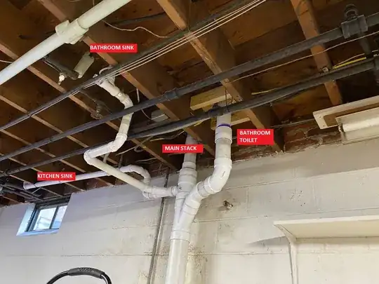

Below is a underneath view of how the plumbing is set up on the first floor:
Basement Plumbing

I see that this is a common placement for AAV's, but, it doesn't allow for very much room to hook my P-trap up to my sink drain. I'm wondering if I can put this AAV somewhere else underneath my first floor and if that will be effective. For example, could I put it somewhere between the bathroom sink drain line and my main stack... does it matter where it goes? So long as it is above where the water flows high enough, is that enough?

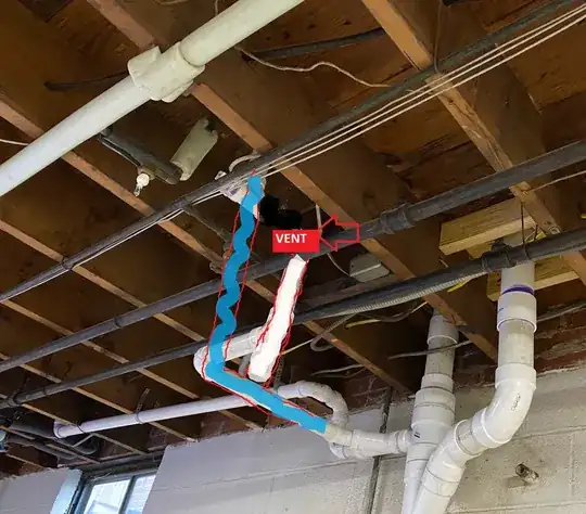

Could I put it like the picture down below? Could I branch off the sewer drain after it goes through the wall and down in the basement like what I've shown? Would that be better? Worse?

You can (in some less strict locales, like rural areas) put an AAV inside a wall or ceiling. The catch is that you will have to have some way to service it, meaning you need an access panel of some sort.
A lot of cities, however, may frown on an AAV that's not readily accessible. Your mileage may vary.
If I were you, I'd simply leave it as you have it dry fit and get creative with some fittings to make it work. It's the path with the least questions (virtually all jurisdictions allow them under-sink).
