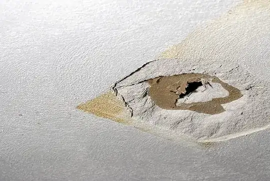

So I did something stupid and I screwed up my den ceiling:
Damaged ceiling
For scale, the hole itself is about 3-4 inches long, but the overall damaged area is about 9 inches in diameter.
It's hard to see, but it looks like there is about 1 inch worth of layers of plaster (?) and what looks like cardboard. The ceiling has a texture to it that I would also like to preserve.
What materials do I need, how do I go about repairing this, and how do I get that textured look?

  • After providing my answer I looked closer to your picture and it appears that your ceiling is a layer of drywall material with a layer of plaster applied over that. If this is the case you can still repair the drywall as I indicated but then you will have to mixup plaster and apply that over the patch out to the thickness of the existing ceiling. Make really sure that you remove ALL cracked and loose pieces of the existing plaster before trying to apply fresh material. Plaster texture is often created by mixing a slightly courser particulate (sand) into the final coat mixture. – Michael Karas Oct 07 '12 at 18:53

I would cut out the area of the hole to a rectangular shape past where the broken plaster exists. If you are very close to a ceiling joist then cut that side right even with the edge of the joist. Next take pieces of pine 1x3 or 1x4 boards and place them up in the ceiling overlapping the edge of the hole. Use dry wall screws to secure the boards through the existing drywall. If there was a ceiling joist by one side then screw the 1x3 flat against the side of the joist so that it makes a 3/4 inch overlap into the rectangular opening. The next step is to cut an appropriate sized piece of new drywall that will fit into the opening. A really tight fit is not necessary. Screw the drywall piece to the already installed pine boards so using more drywall screws.
(Note: Do not try to use drywall nails for any of this. It will create a bigger problem than you already have.)
After the drywall is installed use some of the drywall tape that is an screened mesh with sticky glue on one side. Cut lengths of the stuff and stick it to over the seam edges around the sides of the rectangular area that you had cut out. This mesh tape is typically 1.5 inches wide and I like to put one strip centered over the seam and then run two more, one on each side of the seam so that you get about 3 inches of total mesh coverage to the ceiling material around the hole.
The next step is to use pre-mixed drywall mud and a wide mudding knife to cover over the seams with layers of dry wall mud. I use 6", 8" and 12" wide tools to permit wide feathering of the mud out onto the ceiling over the joint area. The key trick to the mudding process is to not get carried away putting it on too thick. Use thin applications and let dry each coat. If you trowel it in smoothly each time you can really cut down on the amount of sanding you have to do at each coat of the mud. Another two secrets, vacuum and wipe all dust off the patch area after sanding before going to the next steps, and secondly work with the mud from a separate rectangular mud tray instead of the mud bucket. You want to keep the mud supply clean and not let any dry particulate get into the bucket. Any left over in your mud tray should not be returned to the bucket as it likely has junk in it and will lead to misery later!!.
Once you have the patch nicely mudded in and feathered out so that it looks good from the floor as being flat and even it is time to address the texture issue. You can buy cans of spray on texture material but I have had only moderately successful results with them. I have had far better luck with using a 4" paint roller with a very high napp roller. Thin down some drywall mud in a paint tray and then roll it onto the ceiling over the patch area. Note it takes very little water to thin the mud and must be very well mixed. You will have to experiment with the thinned mud consistency, roller napp type and rolling technique. I have found that if you roll out onto the existing textured ceiling you can blend in the patch area very well even if the paint roller applied texture looks somewhat different from the existing texture. Two other tools can be applied to modify the texture as well, a wall paper glue application brush and a large natural sponge. Once the texture has dried apply a coat of primer paint and check the result. If more texture is needed or more blending is needed then reapply mud and paint again.

  • Thanks for the super-detailed instructions. It'll take me a few readings before I can absorb it all. One quick question: Do you think I need to cut all the way to the edge of the damage (9 inches square), or can I just square away the hole itself (3-5 inches square)? – anon Oct 09 '12 at 02:46
  • Cut out all the damage. – BrianK Oct 09 '12 at 03:19
    @anon - Cut out all the damage back to good solid material. Only in this way can you get a decent opportunity to screw in the boards to make a high quality joint for the patch piece of drywall to be inserted. I have patched small holes as small as say 3"x5" where I just inserted a single piece of 1x4 across the hole. When working in a small hole like that do place a temporary 2 or 3 inch screw in the middle of one side of the board so that you can easily hold onto the board whilst it gets screwed to the sides of the patch cutout hole. – Michael Karas Oct 09 '12 at 05:24
  • @anon - note when screwing in the boards or the dry wall patch pieces it is best to use drywall screws and keep them about 1 inch or more from the edges of the drywall otherwise the drywall will break and crumble when you tighten the screws. I also recommend driving the screws by hand as opposed to using a power driver. It is much easier to keep control over the screws this way. – Michael Karas Oct 09 '12 at 05:28
You could use a little fiberglass tape and mud compound and fill it in. Do it in at least 3-4 different steps where each time you lay on a little more drywall mud. Lightly sand it near the end and then paint over the patched area matching the pattern (looks like it might have been brushed with a small broom?)
