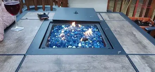

I have a propane fire pit in the center of a table on our patio. Since the weather is still fairly chilly where we are, I was trying to think of something creative to channel the heat towards the 4 seats on each side of the square table rather than straight up in the air. Does anyone have any ideas? Thanks in advance.

  • If you could add some sort of picture that would help. I'm having difficulty visualizing what "a fire pit in the center of a table" really looks like. – FreeMan Mar 27 '20 at 15:29
  • Just added a link – Justin Todd Mar 27 '20 at 15:31
    Ah! Totally different than what I had envisioned. – FreeMan Mar 27 '20 at 15:35

  • So I'm able to use a dial to dictate how large the flames are. My goal is to have it in low flames but redirect the heat to the 4 chairs in each side if the table before it goes up in the air. – Justin Todd Mar 27 '20 at 15:33
  • I had approached the solution to keep the fire pretty. If you were to be ok with it not remaining the same, you could put the metal surface very close to the fire and use a different shape. For example, an old stew pot on a grill grate over the fire. The grill holds the pot close and still allows the fire to go around, and the fire to get air, then when the pot heats up, it radiates the heat off the vertical edges right at you and your guests. The taller the pan the better (a stove pipe?). The hotter you let it get, the better. Red = lots of heat coming at you – Ack Mar 27 '20 at 17:44
  • Oh, I just saw the picture you added and not what I was thinking. It'll be tough to get much heat off of that, it's simply not there in the first place. But to get what heat you can, you can try a metal bowl or any oven safe item with the idea that the vertical surfaces get hot and redirect the heat at you. Probably best to keep your expectations on the lower end – Ack Mar 27 '20 at 17:49
Ack's idea is reasonable, but I don't think you'll see the outcome you're after even with an ideally designed reflector. This type of table works by heating up and then radiating heat energy outward. Radiation dissipates with the square of the distance, meaning that an object at 2 feet from the heat source gets 1/4 of the heat that it would at 1 foot. At 3 feet, that drops to 1/9 (1/3^2). So...

You might look at suspending the cover over the fire, say about 10 inches up. This would force heat to remain in the vicinity longer and keep things hotter. It would also collect and radiate heat itself. You could bend up some rebar legs that sit just outside the pit.
