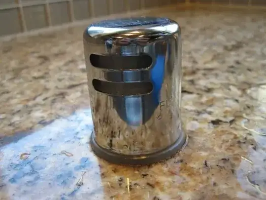

As I mentioned in a previous post, I recently moved to a new place and I'm still trying to figure out what things do. There are still a few things that are particularly puzzling, like what this thing next to the sink is.

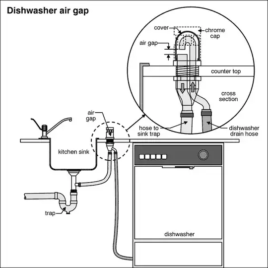

If the top item is near your kitchen sink then this probably an air gap for your dish washer drain system. The purpose of the air gap is to prevent back flow siphoning from the sink drain back into the dish washer.

The top picture is a vent or air gap for your dishwasher.
