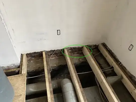

I have torn out the original flooring from by 1910 Victorian so that I can level the joists and install new sound subfloor. I'm using 3/4" AdvanTech T&G subfloor, glued and screwed to the new sisters.
What I'd like to know is if I need to install blocking to provide a nailing edge around the perimeter of the room where the joists deadhead into the brick walls. The original floor had no nailing edge. Installing blocking will be pretty easy in some places, but there are mechanicals that make installing it a challenge in others. There are places where I can't fit a nailing edge within 6" of the exterior wall.
Nailing Edge Here?
Some things I'd like opinions on are:
  1. If I don't install a nailing edge, is it likely I will have a noticeable bounce?
  2. If I should install a nailing edge, but can't fit a full height joist in place, will a 2x4 add enough rigidity to be worth the energy to install?
  3. If I should install a nailing edge, but can't get one within a few inches of the exterior wall, do I just install one as close as possible or is that just a waste?
  4. What would your typical contractor do in this scenario?

Update: Just as an FYI I did not install blocking around the perimeter. 5 months later and there is no noticeable difference between the rigidity of the floor system between the middle of the room and the perimeter. Thanks for you help!
No, because you can't stand that close to the wall. The only unsupported edge is right at the face of the wall
Yes. A 2x4 is more than adequate for that span and use
Close as possible is adequate. Think about how much plywood can bend if you wanted to bend it at say 4" in from the edge, almost impossible
When I was a contractor I would usually not worry about it. 3/4" ply is very stiff (and rated for 24" oc) and as I noted, no one can stand close the wall anyway. If it were to be a tile floor, I might be more likely to add it since tile is so sensitive. I would consider that adding blocking would reduce air flow at the exterior wall in the crawlspace and therefore increase humidity and likely of decay or mold issues.

I chose if I need blocking by placing 2 pieces of flooring on top of each other and stepping in the middle of a span. If the deflection is excessive and it is a high traveled area like a entry door I will block (I normally block at perpendicular entry’s).
At a wall I don’t block in most cases unless the flex in 2 boards is noticeable, remember when you glue and nail the boards become fixed in place. If I feel the new T&G sub is flexing two much I go thicker but this is normally only needed for floors 24” OC however I normally use 1-1/4 T&G with a thin overlay. For vinyl and carpet. Tile I use a backer on top then tile.

I would definitely put in blocking along the wall. The point isn't for support of the the floor the point is to deflect some of the bounce. 2x4 blocking as close to the wall as you can get is more than adequate.
Also not sure why you notched the new joist for electric (sure seems you could have went under) but I would block each side of that too.

    I thought someone might comment on that notch. Good catch. That electrical was existing before the sister. Also, these are not full height sisters, rather they are glued and screwed (and nailed) stiffening sisters. Typically this is done with 2x4s, but I oversized to 2x6s to add additional rigidity (and since I was using them to also level the joists, in some places up to 1.5", I wanted enough meat of the sister to be on the side of the joists). – Doug Hill Mar 30 '20 at 20:12
    So while the notch certainly does reduce the effectiveness of the sister, in my amateur opinion it should still be just as strong as a 2x4 which is typically specified. If my reasoning is wrong here, please let me know! – Doug Hill Mar 30 '20 at 20:13
