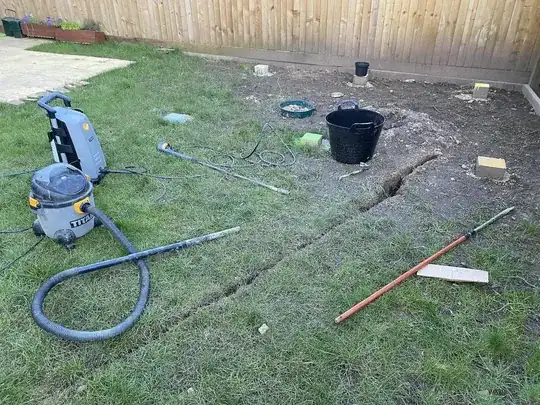

I'm trying to dig a trench for the electrical cable for a shed/office I'm building in my back garden. This is about 7 m long and should be 0.5 m deep. My soil seems to be about 5 cm of soil/turf and then soil which is full of gravel, stones and building waste like bricks, etc. What is the best way to approach this?

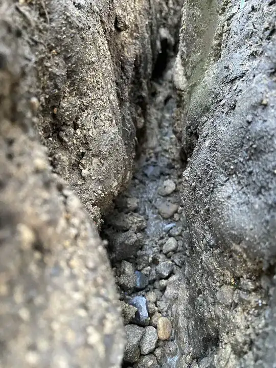

I tried first just making cuts into the soil using a spade to make a narrow slot. That didn't work once I got to the stones.
I also tried using an SDS drill with a 600 mm long chisel bit, but that tends to jam in between the stones and gravel, so I spent a lot of time trying to dislodge it from the ground.
The third technique was with the pressure washer and wet vac, to blast away the soil and suck up the water and smaller stones. This seems to be doing something, but it is painstakingly slow. Since the slot is quite narrow it's pretty difficult to pull up the stones and gravel.
Is there some other piece of equipment I should consider using, or some other technique?

    I dont see any easy way, I would use a mattock and crowbar which is hard work. Clever idea using pressure washer and vac! – Polypipe Wrangler Mar 30 '20 at 21:23

    I like that last photo of the crack! – Willk Mar 31 '20 at 02:03

You got a bad roll of the dice. Very good ideas and attempts that would work in more normal soil conditions. The problem is, if you continue then you will likely undermine the soil because that small rock will fall into the hole from the sides. That will be very difficult to back fill properly and over time it will settle and form a slight ditch / depression.
At this point I think I would call it on the attempt to minimize the work and / effect on the yard and just dig a proper ditch. It could still be narrow-ish, the width of a shovel. This will give you the space you need to backfill in layers compacting as you go and in the end (years from now) it will pay off in spades.

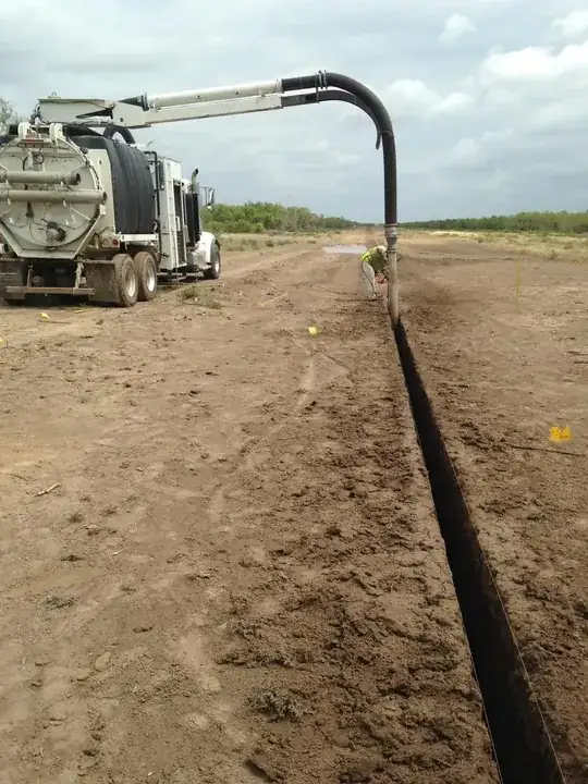

Perhaps an AirSpade or even Hydro Excavation!
A Case for AirSpade:
This tool uses a high-velocity air stream to move and aerate soil so that it can be vacuumed away.
Better yet, find a contractor who has one of these and will come excavate your trench for you using this technology. Here is a video blurb showing its efficacy: Video
Disclaimer: I have no affiliation with this company and no first-hand experience with the product I suggested. I ran across it while searching for something else and happened to think of it while reading the OP's question.
It is possible that the rocks under your soil would prove too much for the AirSpade, however. If that is the case, it's time to talk about hydro excavation
A Case for Hydro Excavation:
This process works much like the AirSpade above but uses WATER instead! It is simply amazing what the technology can do, but is likely to be far more expensive to get a crew out to do your job. It was used by Google while running fiber here in Austin, TX. It created the most beautifully square holes in the ground, with perfectly straight sides. These went down over 15 feet in places. This would really do exactly what you need, as evidenced by this picture:

    Smells spammy, without quite causing me to reach for the flag button – Ecnerwal Apr 01 '20 at 20:26
  • I saw that product before in another video, but I don't think it will cut it in this case. Too much rock and stone to get through. – Matthew Dresser Apr 02 '20 at 21:14
  • I would have loved something like that 40 years ago replacing the water main of my parent's house, but I doubt it would do anything in the mess of rock we have and what he's describing is even worse. – Loren Pechtel Apr 03 '20 at 03:16
  • and still has the same issues, only works in more ideal soil conditions. Also, need the truck needs access which might not be workable for a back yard (I don't know in this case if fenced, if a septic tank, etc) – Ack Apr 03 '20 at 22:36
  • @Ack - Actually, the dig that was done for Google here in Austin, went straight through our caliche soil like a laser. It was pretty amazing. Also, the linked article mentioned the dig can be as far as 500 feet from the truck by using a 'remote kit' which is basically longer hoses... – MrWonderful Apr 03 '20 at 22:45
  • Excellent about the mobility. I would definitely consider this in the future. I often do this anyway with a hose and spray jet for minor soil movement tasks. However, the soil comment still stands, it's not about getting through it in this case and nothing 'narrow' will work as the lower pebble stratification will collapse in from and undermine the sides. The soil you mention is relatively ideal as it is consolidation, dry and has a uniform profile of various sized aggregate – Ack Apr 03 '20 at 22:55
  • My wife would go mental if she came back to find a lorry blasting a trench in the back garden! – Matthew Dresser Apr 05 '20 at 23:06
  • @MatthewDresser - Haha, yeah, no doubt. BUT, it could probably get done in a 2 hour window when she's away, if you planned it right. ;-) – MrWonderful Apr 06 '20 at 10:28
