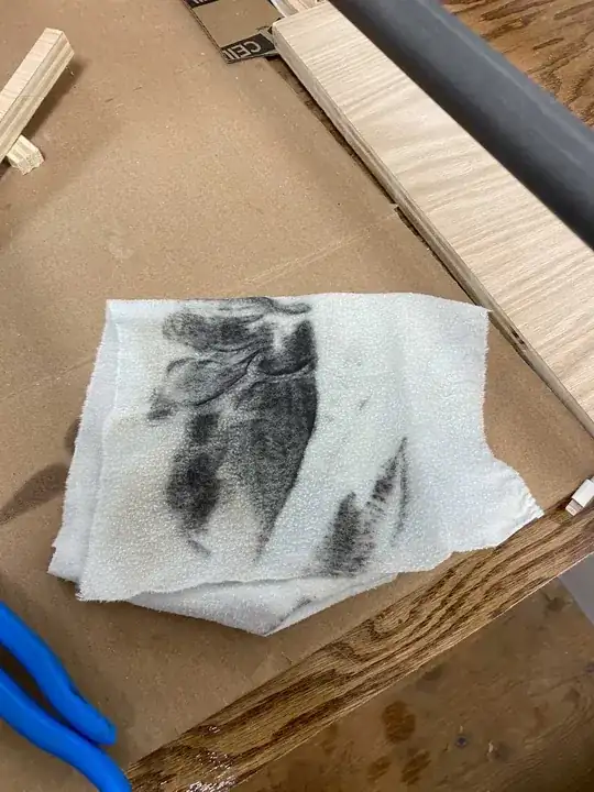

Pure turpentine worked fast and easy. Just saturate a rag and wipe a few times. enter image description hereenter image description here
