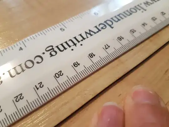

I have a tongue-and-groove laminate floor, laid on 3mm foam underlay on concrete slab. After around 10 years of use, the long edge of one floorboard now drops around 1mm when stepped on. I think there was a slight step or ridge in the concrete slab here, the floorboard was supported by being locked to its neighbour, but now the tongue has snapped off. (Photo below shows pushing down hard on the broken edge.) under load
The floorboard is right in the middle of a large open plan space and lifting the surrounding floor is not really an option. There is also no clearance between the board and its neighbour to insert any tool.

  • @JD added a photo. No wide angle but the total length that sinks under pressure is about a foot long. Either side of that there's no movement, so I expect those parts are better supported. – Roofus Apr 09 '20 at 01:39
