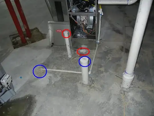

I’m finishing an old (1930) empty basement and have a random pipe coming out of the floor. ⁠I have no clue what it is or what it went to as it sits alone in the space. ⁠It is metallic (tested with a magnet). ⁠It’s currently capped off and did have threading.⁠ I would say it is 3/4in thick. ⁠⁠⁠I am wondering if I can cut it off and recap or if it’s not able to be cut, if I should build it into a wall?
Thanks in advance!!! enter image description here

In a basement, galvanized pipe like that could have been a pipe feeding oil from an underground tank to an oil heater that has long ago been removed and replaced with something else. I had one like that and figured it out by looking at where an old chimney had been removed by looking at the sub-floor structures made to accommodate it. I didn't know exactly where the pipe lead until I accidentally found the tank one day in my front yard while digging holes to plant trees. That was an unpleasant surprise, cost me $10k to have the tank removed and the soil cleaned from leaks.
If it was natural gas, it would be black iron pipe, not galvanized. unscrew the cap and smell it, the smell of fuel oil never completely goes away. If water starts to leak out when you loosen it, tighten it up again right away!

The picture is pretty clear, this pipe was installed when they poured the foundation. It does something. You are going to have to open that cap and smell and possibly stick something in there so you can see whats further in. Short term if this isn't gas you could get an angle grinder to that and shave it off at floor and fill with concrete.
Notes:
  1. My money is on gas. It is just we aren't seeing any duct work coming off of this location. If it is a gas line I would just let the gas company close the line - they usually do this for free.
  2. I am not assuming that they poured this floor when house was built in the 1930s. It just doesn't make sense. I am not saying it isn't but the concrete does not look time period and I doubt they would pour a 1" floor. This seems more likely something the home owner did later on to make the space more usable.

    @Aaron if whiskey be sure to invite us all over for a post COVID party in your new room. Re the cap, I would shine a light down it, I expect that it will 90 degree turn somewhere in the range of 4-10" below top of slab. If it does, it probably goes outside. I did would expect the bend to point to the street, uphill, a yard, near a driveway, near the garage, or some combination. It's probably going to a tank. HIGHLY doubt a hidden room. Don't cut until you clear any explosive gases out. I'd probably chip out the concrete so when I put a new cap on it was even with the slab. then fill in around – Ack Apr 08 '20 at 03:59
    I'm not seeing any patching around the pipe, which would make it part of the original 1930s construction. That rules out the possibility of it being part of a radon system. – Mark Apr 08 '20 at 19:59
    @Mark - I agree but since this is supposedly just an inch thick I am not sure there is any assurance that this was poured when how was built. My money would be on gas lines as I have seen similar gas lines for furnaces in my area... The thing we didn't get any pictures of duct work... so that is hard to guess too. – DMoore Apr 08 '20 at 20:02
