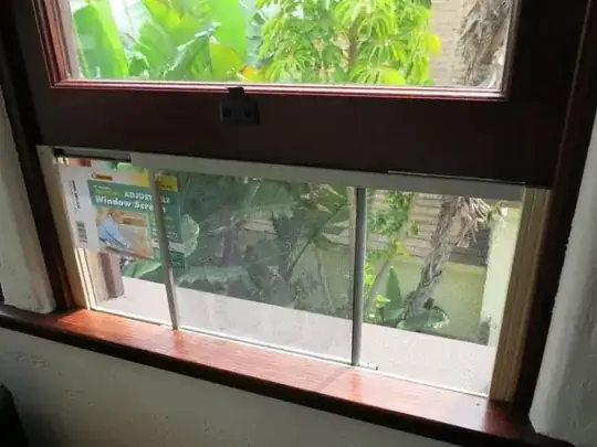

You could go with an
adjustable window screen,
One that is just tall enough to discourage your smart cat but not so big it blocks the entire window and your view.
It slides to adjust to the width of your opening, you could put it up when needed and take it down when not needed.
If it does not fit exactly or does not stay in place then You can make some modifications and learn to love your adjustable window screen.
Alaska Man
  • 13,521
  • The window in your photo opens vertically, while the window in the OP is a tilt-out version and won't take this design of screen. – fred_dot_u Apr 14 '20 at 21:59
  • @fred_dot_u - Yes, the photo was just to show the screen. It would still fit between the window rails and be enough of a deterrent for the cat. ( *not flies or mosquitoes* ) It could be enough if the window is not opened fully. No unauthorized mechanical alterations to the window mechanism needed. – Alaska Man Apr 14 '20 at 22:08
  • I see that now. By having the spread-open type, it brings the opening to zero and places it higher up as well. Much simpler than my answer, unless the cat is really smart. – fred_dot_u Apr 14 '20 at 22:13
