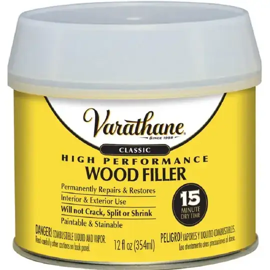

There are a number of wood and even glazing products that can work for you but I recommend that you use a wood filler. Just clean around the damaged area removing any loose material and use the wood filler according to instructions.
Smooth it on with a putty knife. Some wood fillers shrink so you might want to do a slight overfill. If the gouges are deep it might take two applications.
You can then sand it smooth and paint. Wood filler has wood fibers in it so they will take paint well.
