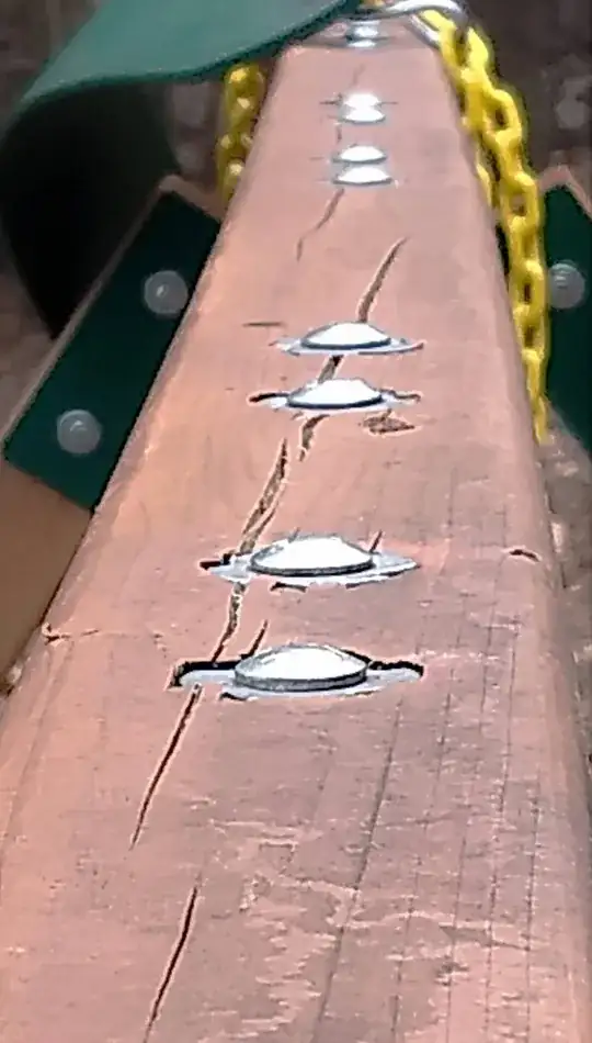

This a 3 year old (lightly used) weather exposed swing set.
Should I be concerned about the cracks?

  • You did not indicate if the cracks are on the bottom side of the beam or only the top. That would be useful information here. Also, can you probe one of the cracks with a long thin probe and let us know how deep the deepest crack is. What are the dimensions of the beam? – Itsme2003 Apr 16 '20 at 17:36

This is typical of wood movement. The wood will eventually start to rot because of the "pockets" created by the cracks. Those will hold water, expediting the rot that will occur over the years.
Cedar is rot resistant, but with these cracks it will quicken the inevitable. If a well formed metal cap can be added to the length of the top which would be preferred so it can be fastened on the sides, or covered with a peel and stick waterproofing, so the movement of the wood will not affect the covering. This is another preferred fix, since a metal cap is a nice harbor for insects, depending on how close it is set to the wood.

It is not stress from the weight of the swings nor is it because the wood is cedar
It happens to all species of wood and he cracking was caused by sun drying not structural issues such as overloading.
Wood expands and contracts on the sun dried side and the sun also has an aging affect on the wood making it more hard and brittle (less able to tolerate expansion and contraction cycles). This causes the wood to tear apart in the weakest places which is the softer spring growth layers that are in between the strong fall growth rings (lines on the edges of the boards).
Is it an issue that you need to fix?
No and yes.
No, in that it does not yet need to be replaced. It is not a structural issue right now (I suspect that the cracks don't come anywhere close to going through the entire beam). It likely won't become a structural issue ASSUMING that it doesn't also get further weakened by wood decay (rot) that is likely to occur in the cracks.
Yes, it that it is necessary to fix the situation by protecting the wood from further damage. Do this by protecting it from both moisture and the sun's rays. This can be done in many ways including such things as metal flashing, brush on sealant, or a rubberized roofing member.
Suggested Action
I suggest cleaning the debris out of the cracks and then covering the top of the wood beam with a rubberized roofing material to prevent moisture from rain and the drying rays of the sun from getting to the top surface of the wood. This material should be available in most home improvement stores

    If water gets in any way other than coming straight down (dew, seasons of high humidity, storms with strong winds and semi-horizontal rain) then a waterproof rubbery layer on top will make it rot much worse. I would use a good treatment for any existing rot then coat with a sealant or exterior-grade polyurethane. – R.. GitHub STOP HELPING ICE Apr 16 '20 at 00:02
  • by what process would water get in? Polyerethane will soon crack and you're have the condition that you say it is the solution to. You solution does not address the very cause of the problem, sun exposure – Ack Apr 16 '20 at 00:09
    That's why I said exterior-grade. Not the rigid stuff you'd use on floors. – R.. GitHub STOP HELPING ICE Apr 16 '20 at 00:14
  • we used to use it for the mast of our sailboat. It has to be reapplied very few years. And ALL of the items on the mast had to be removed to ensure that all the surfaces were covered otherwise water would find its way in under fittings where it would not dry out (because of the issue you are attempting to address). I remember this because me, the kid, had to do all the damn sanding to ensure that it would adhere correctly. To do the swing set, all the bolts must be removed or water will get in under them or cracks that will if the PU is applied over them due to expand/contract cycles – Ack Apr 16 '20 at 00:32
    If it was that long ago, you were not using modern formulations. – R.. GitHub STOP HELPING ICE Apr 16 '20 at 00:51
    It was during the age of the dinosaurs. This has the merit of being another approach, how about you post it as an answer? – Ack Apr 16 '20 at 00:56
  • Would a couple of coats of Boiled Linseed Oil on top be any help before capping with flashing? – Criggie Apr 16 '20 at 02:55
  • Not with the rubberized cover as it is going to be a glue-on / sticky-on situation and oiling the wood would reduce or eliminate the ability to use the rubberized cover. By itself, it might help, I don't know. I would expect that it would need regular reapplication. – Ack Apr 16 '20 at 03:22
  • I'd rather pour some oil based paint/coating for outdoors into the crack. It'll harden and seal, possibly you'd need a recoat after 1st layer dries, but after that it should be set. Usually they come with anti-fungal additives. – Stian Apr 17 '20 at 07:40
This is known in the lumber and construction industries as "checking", and it's normal. Wood contracts about its circumference as it dries.
As long as it's parallel to the wood grain it's generally not a concern in the short term.
Weathering of the member certainly was the initial cause of this cracking. As the wood expands and contracts with the seasons, the countersunk washers remained (relatively) the same size and thus the wood split. The fact that the member is splitting along the bolt line leads me to the suggestion that this should be replaced.
represton
