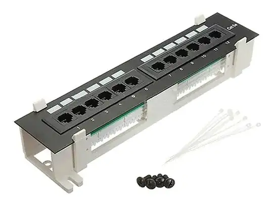

A Patch panel to mount on your wall, this one has 12 ports. You can use several, or some patch panels have 16/24/48/96 ports. Comes down to cost. Some patch panels are designed for rack mounting - you don't really need this. enter image description here
