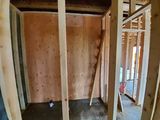

Many of the shear panels have nailing that is too narrow and too short. I verified with my designer and the nail manufacturer that the nails are wrong and do not have the shear strength of those specified in the plans.
Interior shear wall

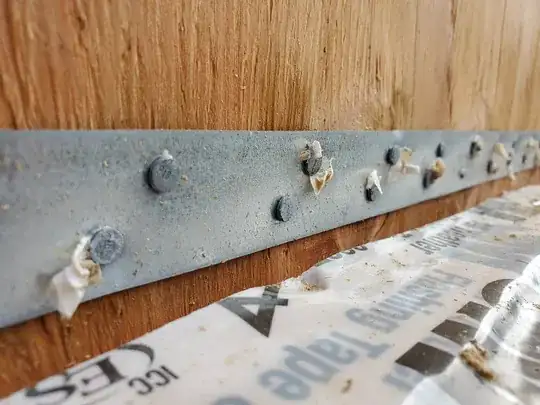

Moreover, almost all of the Simpson seismic hardware on the outside of the building (twist straps and coil straps) was installed with nails that are also far too short. Simpson requires a minimum 2.5" nail when nailing through sheathing. My framers used a 1.5" nail.
Inadequate nailing on Simpson coil strap Inadequate nailing on Simpson twist strap

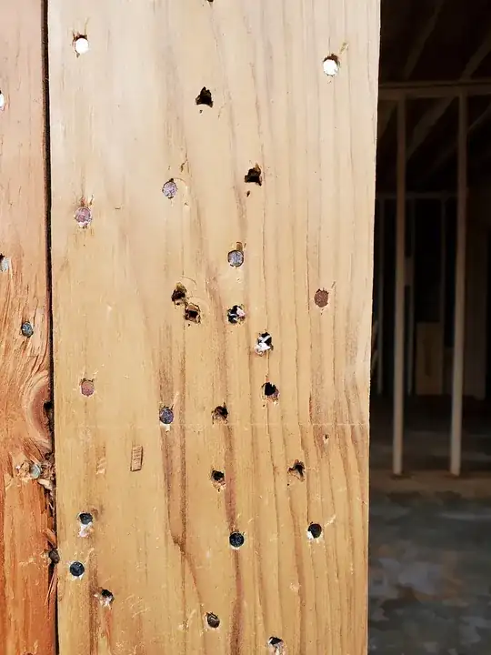

In other places, the nailing on the sheathing, and the sheathing install generally, is just plain terrible:
Extremely poor sheathing nailing Poor wall sheathing installation

    I'll let our engineer-minded folk like @LeeSam weigh in on the panels done wrong, but I can tell you that pulling nails from the straps isn't as hard as it might look. Simple cats paw/hammer work. Now, putting a longer nail back into the same hole might not be great if the nail is the same diameter... – Aloysius Defenestrate Apr 20 '20 at 22:28
    I doubt if you could pull all the nails. They look like they were set with a pneumatic hammer (nails are slightly recessed). Removing a nail would destroy the sheathing. – Lee Sam Apr 21 '20 at 00:05
  • How do you know the diameter (and grade: box or common) of nail is wrong? Length is not so critical and often “shorts” are provided by Simpson. I doubt you could increase the nailing to account for the wrong nailing without splitting the supports (studs). – Lee Sam Apr 21 '20 at 00:13

Where possible I'd make them double up the straps. Install another strap along side the existing strap with the proper nails (depends a bit on post/beam width/strap locations). Specifically what hardware was involved in your seismic design, you can do this for CS16s but SHDH10s are embedded in concrete and I've looked at the post pour hardware and that isn't fun to install so if you have those maybe pull the nails and upsize the diameter and length of the fastener.
On the shear walls you could add nails to the sheathing up to 3" oc. The on edge nailing is typically tighter than the in-field nailing so maybe you can only do it on the field nailing. The best thing might just be to double up the studs on the inside so you can get your nailing pattern. You'd loose insulation value in the wall but certain if you double the studs then you'd reach design strength.
For specific walls you could add the Simpson Steel Strong-Wall hardware which is usually designed for large openings but which can do a lot of shear in a small area. Possibly adding a few of these in select locations is better than attempting to adjust the sheathing.
Another option is putting a shear layer of plywood on the interior of the studs. That is often done in seismic retrofit when the cladding is already installed.
