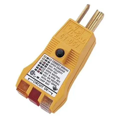

I would get a circuit tester like this to insure the adapter is actually safe.

Downvoted (sorry!) because cheater plugs are just that -- cheaters. It might be different in places like Chicago with tons of conduit, but I *never* find a ground on an old outlet. And I know you said to get the tester, but that's just the path to heartbreak. – Aloysius Defenestrate Apr 23 '20 at 18:55
1Thanks for explaining your downvote. I expected that from certain types of people. I'm sure completely rewiring her house is a much more practical and realistic solution...OK, that was a bit sarcastic (sorry!) – Steve Wellens Apr 24 '20 at 04:39
