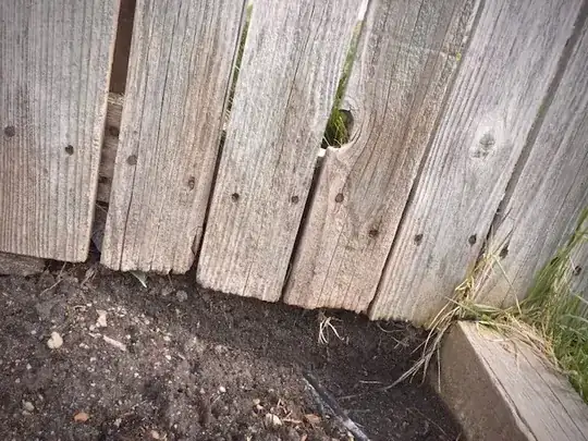

Our neighbors yard is elevated and they water their yard a lot. The water flows over into our vegetable garden and floods it. I would like to add a barrier. Some ideas have been slim pavers with a plastic sheet, or a tree root guard. I looked at grass barriers but they are only 5-6 inches wide - this will need to be at least 12 inches to go into the soil and be tall enough to stop the water flowing in. What could I use as a good barrier?

In the last picture, it appears that grill (?) is sitting on an area below the garden and that past the gate it slopes down towards the street. – JimmyJames May 07 '20 at 20:39

A quick and easy solution would be to get a 2" x 12" x 10' P.T.board and bury it a few inches into the ground along the fence and screw it into the bottom of the fence. You could extend it as far as you needed along the fence. Get a board rated for ground contact.

1Bear in mind that this will, if sealed well enough, be causing the water to pond in the offending neighbor's yard (to his detriment). It will also be pooling around the fence in the picture, and if the fence is _yours_ it will be rotting out your fence much more quickly, necessitating a fence repair/replacement much sooner than intended. Also, the gaps in the fencing are rather large, so as soon as the water level tops the dam, it'll spill over into your garden anyway. You may need to raise the level of the dam high enough to prevent that from happening. – FreeMan Apr 14 '21 at 12:40

I can't see this helping enough, unless the top of the mulch is lower than the lowest part of the gap under the fence. Most likely the water will run under the fence, then under the mulch. The mulch can 'wick' some water up from underneath, but not very much. – Ben Hull May 08 '20 at 02:57
