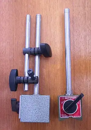

From https://en.wikipedia.org/wiki/Magnetic_switchable_device
A magnetic base.
These have a circular core which can rotate 90 degrees. In the on position there's a solid magnetic field from the underside, to hold the base on a ferrous surface like a lathe, drill, mill, or similar Big Tool. When off, there is minimal magnetic attraction so the unit can fall over, but it won't attract metal chips and filings.
