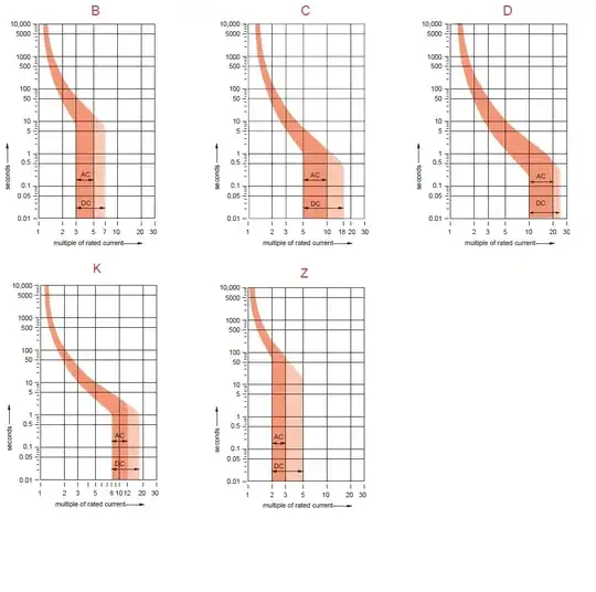

For that matter, do any breaker's trip curve begin before it's displayed rating? Are such breakers in common use? common trip curves
  • The curves combine both functions of the breaker thermal and magnetic. Slight adjustments can shift the curves but these are sealed at the factory for the specific value on the breaker. You could say the curves are in use below the value as heat takes time to build. On the large frame industrial breakers I test the values are quite a bit different on the 15-20 amp. – Ed Beal May 17 '20 at 02:23
First, I don't know about those charts. (actually I do know; I browsed them on Friday as part of other research; but you need to look at context and notice they are and NOT for breakers in your home.)
The only trip curve that matters to you is the one published in the catalog for the breakers that are in your own panel.
It's possible to get breakers with trip curves like that, but they don't fit your HOMeline panel lol, and they don't cost 5 dollars! They do, however, let you deep-dive into the arcane subject of breaker selective coordination, i.e. the fine art of reliably and reproducibly having the local breaker at the hydraulic press trip before the feed breaker back at the main panel 3 floors down.

  • Your diagrams show sharp edges of the relevant areas which are defined by current and time. But those are only average data. For the specific tolerances, the manufacturers' data should help. – xeeka May 17 '20 at 16:50
