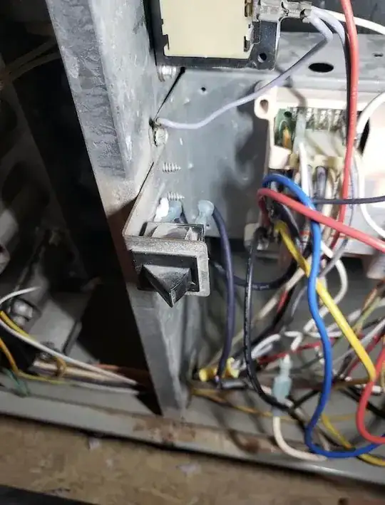

This is the power button I'm referring to: enter image description here

I don’t think that is a power switch. That is a safety switch that is depressed by the cabinet panels when you put everything back together. It should not work unless it is depressed. You should be good. Not sure how you got shocked though.
Rward73
  • 234
    Indeed, most furnaces/air-handlers have an interlock of that nature so that the furnace isn't running unexpectedly when someone has their hands inside it – ThreePhaseEel May 21 '20 at 22:55
  • I kinda wondered if maybe the panel was supposed to hold it down, but i thought when I was messing with it the day before that the switch was clicking and power was staying on to the control board, but then again I was immediately pressing it again to toggling it off (at least that's what I thought I was doing). Probably just misremembering what it did. – Mordred May 22 '20 at 00:17
    OP got what they deserved by defeating a safety circuit.That's a 120v switch with exposed contacts behind it, which when off kills the power to all 120v wiring *on the OTHER side of the switch*. Meaning, if you don't have the, required by code to exist, local disconnect (usually a simple light switch) *off*, ONE of those wires can still bite you. – Mazura May 22 '20 at 09:26
    Even w/o your thumb energizing *all* 120v wiring inside the case which has sections of exposed contacts throughout, **this is why it exists.** – Mazura May 22 '20 at 09:34
    @Mazura Yeah, it makes perfect sense now. The A/C tech who diagnosed the motor was out left everything open and exposed so I was unaware that the panel was depressing the safety switch. There's definitely a chance I brushed the contacts which determine the direction the motor spins while trying to verify that the airflow through the fan was in the correct direction. – Mordred May 22 '20 at 17:16
