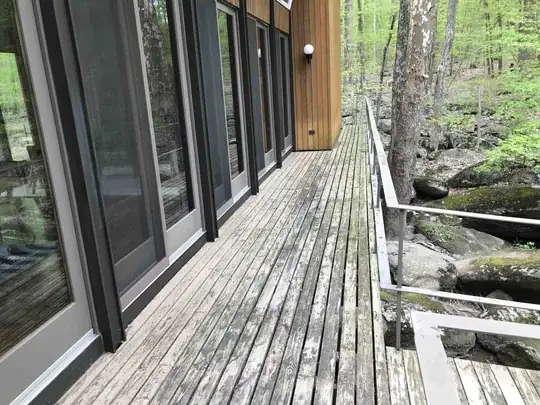

2x Ipe is cost prohibitive, double the cost of the 5/4 Ipe. However Ipe is the way to go. Therefore we're thinking of putting a 1/2 inch shim on joists or putting a 'sister' joist that is 1/2 inch proud. We need the decking level to be the same after the thinner board. If there were a gap or even a filler bit under the doors and siding it would look like a mistake. There are 12 doors that meet the decking.
One pro suggested rubber flashing to help hold the 1/2" shim in place and bonus shed the water. Explain again why you wouldn't do this? How else to support doors?enter image description here

  • This is the first I've seen of this post since you added a pic. That's a _spectacular_ setting! IMHO, the grey, weathered deck blends perfectly with the rock below it. Of course putting new, not rotting & mossy wood in isn't a bad thing... It appears from the pic, that there's a trim board below each door. Does that trim board only reach to the top of the deck board, or does it pass below the current surface of the deck? If it passes below the surface, then the only issue you're looking at is an additional 1/2" step height and repainting that trim board. – FreeMan Jun 15 '20 at 15:07
  • Freeman, thanks. We are actually thinking of staining it to match the brown of the columns between doors rather than the grey. Yes the trim board sits on the decking, all the doors around the house. Furthermore, this section of deck we are planning to run the boards 90 degrees from where they are now. I will have to add joists perpendicular to the existing and it will be easy to add the 1/2 inch in most of this section. – Trout Jun 15 '20 at 15:13
    Ah, adding new joists at 90° to the existing ones will solve all your problems. The alternative solution (if you were going to keep the decking in its current orientation) would be to simply replace the trim boards with taller trim! After the installation, nobody but you (and the us here:) would know that the current trim was taller than the previous trim, and the step height doesn't look like it would be an issue in the least. after 2 or 3 days, you'd quit tripping up the step because you'd be used to the new height and all would be good! – FreeMan Jun 15 '20 at 15:26
  • Consider writing your own answer indicating that you're going to put in new joists at 90° and use them to raise the deck height to accommodate the thinner decking. If you don't answer and accept the system will continue to bound this question to the top of the list every few months for year to come... – FreeMan Jun 15 '20 at 15:27
  • True that, however we're only swapping direction for the one section, other sections will need the shim / sister treatment. – Trout Jun 15 '20 at 15:29
