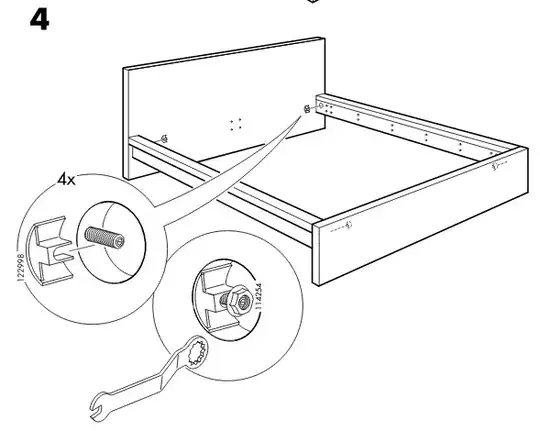

Looks like an IKEA bed to me - something like the MALM or the HEREFOSS.
You first remove the metal rail, then undo the nut. The manual depicts a wrench (ikea part 113453) but a regular metric 13mm wrench reportedly works fine. From the assembly instructions:
IKEA MALM bed image

    I've got one next to me here, recently dismantled as we need an office not a spare room. My normal double-ended spanner of the right size worked, though even my smallest adjustable didn't. You only need to use the spanner for a turn or two, then you can slip out the plastic spacer shown and finish removing the nut with your fingers – Chris H Jun 03 '20 at 11:00

  1. Remove the metal rail.
  2. In the opening, you now have enough room to insert an open-end wrench.
The wrench has a slight angular offset. Push down on the wrench as far as it goes, remove it, flip it over, reinsert it into the hole and repeat ad nauseam.
