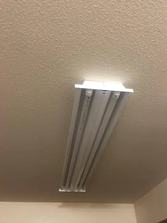

These F32T8 kitchen light bulbs stopped working, so I replaced them with these bulbs. After I replaced it, the lights turned on fine the first time. However, the lights no longer turn on. I've checked that the new lights are compatible with the old one and I have also checked the circuit breaker. How can I fix this? Thank you.
Additional: Immediately after the light bulb change, the light was on for 1+ hour. However, once I turned it off, it did not come back on. Just now, the light turned on when I was flipping the switch. After that, it does not come back on again.
Not sure of the model of the light fixture

  • The lights will very rarely turn on, as it only turned on once when I flipped the switch at least 20 times. That one time it turned on, I turned it off within 5 seconds and tried another time, which did not work. I have added a photo of the light fixture, and I am not sure of the brand / model of it. – FiveDollarFootlong Jun 04 '20 at 12:56

Sounds like a bad ballast. Ballasts do not live forever and need to be replaced from time to time.
The evidence isn't all in, but I'm inclined to believe it has a bad ballast. The ballast is an electronic module inside a fluorescent light that regulates current to the light. It's essential for fluorescents.

Given the bad ballast, you will be forced to rewire something. A wiring diagram here may be useful.
Replace the ballast with another ballast.
At that point you can run either Real Fluorescent (try the 90+ CRI tubes) or plug-and-play LEDs. This is a 2-step process:
  • identify your existing wire colors from the ballast. If you have 2 yellow 2 blue 2 red, you want a Rapid-start or Programmed-start ballast. If you only have 1 red 2 blue, then you want an Instant-start ballast.
  • Now shop for a ballast that supports 2 x F32T8 (which will be easy, since most do that). If you think the room has too much light, someone on eBay is selling a fantastic but very dim (only 71% of normal light) ballast for $5 each.
  • Then simply cut the wires at the old ballast, swap ballast phyiscally, and hook up wires by number - 1 yellow to 1 yellow, 1 red to 1 red, etc. I use blue (small) wire-nuts for this.
