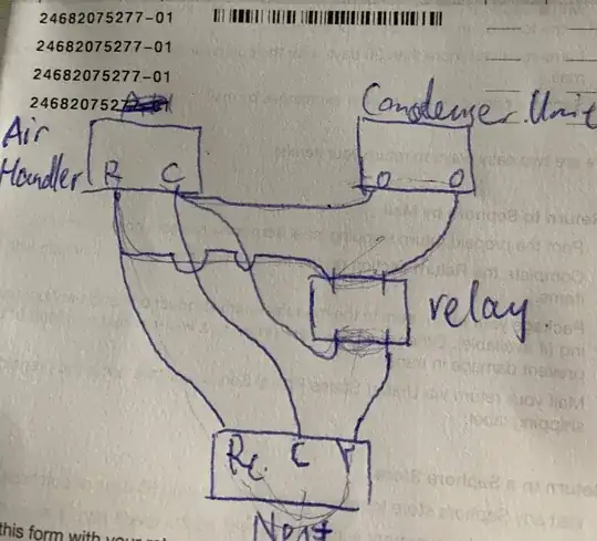

I've read a reddit post that suggests adding an isolation relay (though the post added the relay on the heating side). I have not purchased a relay yet but did sketch the wiring that I think should work relay wiring.
I'm wondering if the relay is going to work or there is other solutions. If the underlying issue is indeed leaked voltage, then will having a relay simply hide the problem, e.g. the chattering may occur at the relay?

This is a hack, but....
Try replacing the relay with a much heavier duty one. Specifically one with a coil that uses more power. 24v is a very common contactor voltage.
Here's one option from Grainger, but really any 24Vac coil voltage relay would work. The contact rating must be equal or greater to what you currently have. Aiming for very high voltage/current contact ratings, or relays with more than 2 poles will likely get you a higher-wattage coil, and that's what you want to reduce chatter.
The heavier duty coil will pass more current through without moving. In fact you don't need to remove your current relay. maybe just connect another in parallel with it so its powered on at the same time. Leave a note for why you did that, or the next hvac tech you have out might yank it and tell you how crazy the last guy must have been to put that there.
Or for that matter, you might be able to put any sort of load in parallel with it. A suitably rated resistor for example.

  • The thermostat is detecting the c wire and the voc/vin/lin readings are normal for having a c-wire according to nest support. The voltage at the thermostat is all normal: 28v from Rc to c and y and g. But at the compressor, the voltage between the common and yellow fluctuates rapidly between 0 and about 2v (> 2v for a few moments) when the thermostat is on the backplate, and chattering occurs. If the thermostat is removed or with the old honeywell, 0 voltage. I think the thermostat is faulty and tries to steal power even with c wire. – David Li Jun 06 '20 at 15:05
  • I'm going back to my honeywell for now. The resistor idea may just hide the nest's problem of leaking voltage even if it can stop the chattering, still thank you very much! – David Li Jun 06 '20 at 15:05
  • Something else I just thought of. There do exist 'time delay relays'. With them the coil has to be energized for a number of seconds continuously before the contacts close. I have a hunch that modern fancy ones just use silicon, so they wouldn't work at all because they wouldn't bridge much of a load. But if you found an electromechanical one it might do the job. Then again it's really an ugly bug in the nest thermostat. Speaking of bugs, have you made sure it's on the latest firmware? (I do realize how insane it is to think of firmware versions on a thermostat....) – Billy left SE for Codidact Jun 06 '20 at 19:56
