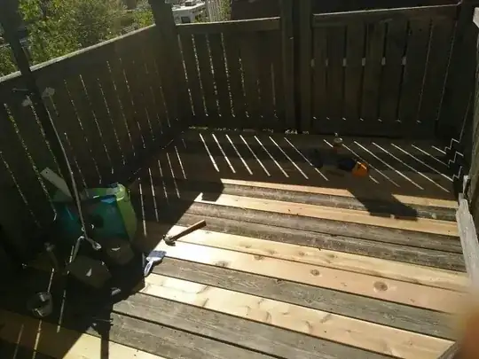

I'm restoring my untreated/unsealed cedar wood deck. It was left with no care for 12 years old before we bought it.
I changed the damaged board and I'm now at the sanding stage. I saw all the how-to guides, but the only question that I have is: is it necessary to clean (either w/ high water pressure or with washing product) the wood if I'm going to sand it anyway?
The surface will be a mix of old (12 YO) and new cedar.
Matt
  • I don't see any fasteners, so I'm guessing you've used some sort of hidden fastener system. Bear in mind, though, that if the fasteners _are_ exposed (but just not visible in this pic), that sanding will _most likely_ impact them where pressure washing will not. – FreeMan Jun 09 '20 at 15:55
No washing will not really help and will slow the process, to get things to match a fair amount of sanding may be needed to remove the weathered surface. In cases where I have a mix I usually paint but some stains will work ok.
