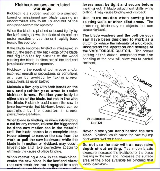

Skil gives two reasons for it.
From the operating manual for a Skil brand circular saw:
"to minimise splintering"
and in the "kickback" warning section:
"to reduce the chance of kickback"

    There's also limiting how much blade is out to "what is needed for this cut" in the unfortunate instance that you manage to screw up and cut yourself... – Ecnerwal Jun 10 '20 at 12:25
  • The curious might also consider searching videos of saw kickback, to see how quickly it can become dangerous. It's not a situation where a human has nearly enough time to react, and is a good visual demonstration of why the chance of it happening should be minimized. – brenzo Jun 10 '20 at 17:23
    As an example of what kickback can do: In 8th grade shop class, there was a kickback during the period before mine. A 2x4 was thrown off the table saw, over 6 rows of (fortunately unoccupied) student desks (30+ feet), and made a deep, 2x4 dent in the chalkboard. Had any students been there and one took that unfortunate moment to stand up, his head would have saved the chalkboard, but... – FreeMan Jun 10 '20 at 19:12
  • One reason that is sometimes given for doing the opposite (settings the blade with a greater depth than recommended here) is that it reduces the total number of teeth contacting the workpiece at any time during the cut. By exposing more of the blade, the teeth are (as the theory goes anyway) better cooled by the surrounding air. The claim is that this makes for a cleaner cut and is less likely to burn the work piece. (I've heard this argument made for table saws, but it seems like it would apply here too). – Z4-tier Jun 11 '20 at 17:22
  • It's amazing how many things can be answered with Read The Fine Manual. I was talking with a guy who had trouble figuring out how to cut crown molding on their new miter saw. I recently purchased the same saw and let them know that the manual has instructions for crown molding. – MonkeyZeus Jun 12 '20 at 15:10
