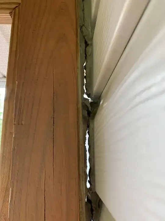

I have a sunroom which is right next to the siding of my houses:
Sunroom
However, as shown below, there are some gaps between the siding and the sunroom, and some bees go inside the gaps and make holes.
I’d like to block the gaps so that bees can’t do any more.
I am not the original owner, and my house was built 25 years ago. I found that there is some sealant (a bit dark gray) between the siding and the sunroom, but the sealant between them is disconnected because the sunroom might have moved a bit, I guess.
Can you guess what the material of the sealant is? Do you think Plumber’s Putty could be applied on top of the existing sealant? Would you recommend any products or any approach for my situation?
I am very worried about holes bees make because I found that some holes were very deep and the wooden post in the overview got a bit rotated for some reason.
Thank you so much for your advice in advance.
-Sam

It's possibly "duct seal", a flexible and sticky material sold for plugging cable entrance holes. If so, you can add more over the top. You'd work it into a rope by rolling it between your hands, then press it in place.
It could also be some sort of tube caulk. Since it doesn't appear to be silicone you should be able to bond to it with either duct seal or caulk.
A better fix might be to scribe-fit a thin trim board to the siding. You'd do this by tracing the siding using a spacer, then cut to fit with a jigsaw or similar.
That had better not be plumbers putty! It should be caulk that has, after 25 years, simply started drying out and failing. This is about the normal life-span of caulk, so it's nothing to be alarmed about. Actually, it's beyond normal life span.
What you want is to clean out as much of that old caulk as you can. Use a putty knife or other stiff, flat, not sharp blade to scrape it off of the wooden posts and off of your siding. If you use a sharp blade, you're very likely to cut into the post (not critical, but it's an annoyance) and/or the siding (a critical issue as you've now created an easy way for water to get behind your siding and start rotting the sheathing and studs of your house).
Once that's all cleared out, get several tubes (and a caulk gun if you don't own one) of good quality, exterior grade latex1 caulk. It comes in a number of colors, so you should be able to find a light tan to be close to the siding color, a brown that is similar to the post color, or possibly clear. Using the caulk gun, pump a wide bead of caulk into that gap, taking your time to ensure that you've completely filled the space between the post and siding and that it seals against both sides. You might want to cut short pieces of backer rod2 and put them into the larger 1/2 to 2/3 of the gap between the siding and post (where the gap is the biggest) so you don't have to use as much caulk.

25 years ago, it may have been the old butyl rubber caulking, commonly used for flashing, gutters etc.. It would have been good for about 20 years, it appears to have been originally put on with a caulking gun. As said, clean it out as best you can, then use a silicone latex based caulk to replace it.
