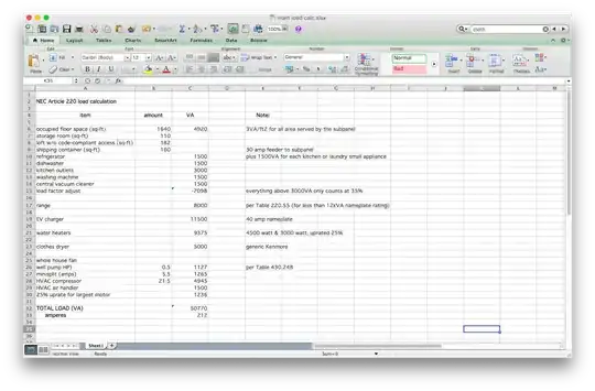

My house was built 32 years ago, with 200 amp electrical service. Since then I have added a number of large electrical loads, and decided I should do a load calculation for the entire house using NEC Article 220.
Here is what I have so far:
Items I'm unsure about:
Lines 7, 8, 9: Are these square-footages part of my dwelling unit, and thus part of the 3VA/sq-ft calculation? Do they not count at all, because they're not habitable living space? (Lines 7 and 9 are un-heated, and line 8 does not have code-compliant access, an uncompliantly-steep spiral staircase). Does line 9 require a calculation outside the 3VA/sq-ft, since it's served by its own subpanel? It does not, however, have hardwired loads.
Am I counting the EV charger correctly? It is a Clipper Creek HCS-50, rated at 40amps, calls for 50amp breaker & wiring.
Am I counting the water-heaters correctly, do they need to be uprated 125%?
Does 220.53 reduce my total at all?
Anything else that seems wrong (in either direction)?
Not quite. The EV must be accounted for at 125%, hence 50A breaker. 50A x 240V = 12,000 VA.
