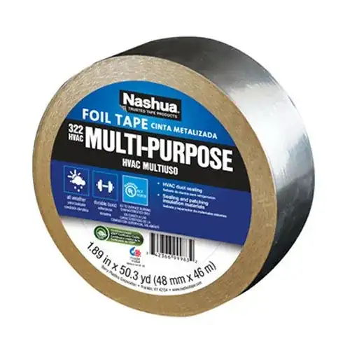

"duct tape" - this is what it is actually designed for! Though actually I would use a good metal tape like:
However, would that explain 30% difference in energy usage? No. Maybe 1%, if that, since any leaked air is still going into your house and not to to the outside.

    Note that "duct tape" is ironically a poor choice because [it doesn't adhere well to ductwork](https://tapeuniversity.com/industry/hvac-industry/why-cant-i-use-general-purpose-duct-tape-on-ductwork/). Foil tape is the right answer for ductwork. – Machavity Jun 24 '20 at 12:51

  • @Machavity Which is why I specifically included a link & picture of foil tape. That stuff (not that specific brand, foil tape in general) is really good. – manassehkatz-Moving 2 Codidact Jun 24 '20 at 13:39
  • Yeah, but you started with `"duct tape" - this is what it is actually designed for!`, which I took as an ironic statement, but some users will not. – Machavity Jun 24 '20 at 13:43
