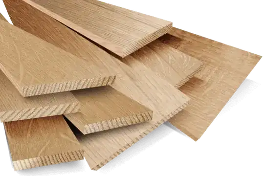

If you want to minimize the chances of your boards cupping, you need to purchase quarter sawn lumber. This will be significantly more expensive than the plainsawn lumber you show in your picture, and it will not guarantee that it won't cup on you, but it will significantly reduce the chances of cupping.
You can tell a quartersawn board by looking at the grain. The face grain will be very consistent along the length of the boards like this oak is:
