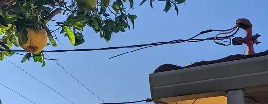

After trimming the old tree, we found out that the steel cable supporting the main feeder lines is broken:
Must have been like that for years. The actual feeder wires are fine, the electricity is on. The steel cable seem not to be really connected to any electrical part, so I assume its function is only to hold the wires.
Question: is this something I can fix myself, i.e. by simply clamping them together? Or it requires welding? Or full cable replacement?

You can see right there where the steel cable is bonded to the lighter colored of the three service entrance wires.
Yeah, you lost a neutral. This is when we get out the big font and say
This is a power outage. Call your power company NOW.
Normally these arise as “Hey, my appliances keep blowing up”... or “I measured 84 volts on an outlet” “check your other ones” “Oh, this one is 148 volts”.
But the funny thing about lost neutrals is people can take quite some time to realize they have the problem.
But yes, that wire is electrically “hot” - well, it’s near ground voltage if everything is working... but if you go up there and try to rejoin it, you’ll end up with one wire in your left hand and the other wire in your right hand, and the neutral current will try to go through you.
Of course, you said “feeder”. That is a word with a specific meaning: it means a cable after the meter going between panels. So supposedly you would have a house and a pole barn or something, and an overhead line feeding a subpanel out there. But that would be 4 wires (with messenger as ground), not 3 as we see in this photo.
The specific name for this cable is “service drop”.
And the service drop is in the power company’s bailiwick, so they will fix it for free in almost every case.

You should not go near that. Call the power company as soon as possible and tell them a wire on your service drop is broken. It appears to be the neutral for your triplex service. They should fix it at no cost.

The bare connector is a neutral and carries the imbalanced load, and now is relying on the ground rods and other electrodes to conduct the difference between the 120v conductors back to the transformer.
It must be replaced. Normally the overhead conductors are the property of the utility and the user has no authority to service it.
You should call the utility immediately to replace it, you may have some difficulty convincing them you had no part in damaging it, hopefully you can ask them to look for rust on the cut surfaces.
