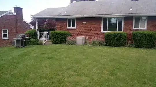

I live in an area where 99% of homes have gas lines, but mine does not. I called 811 and the gas company showed up, but said since I have no gas service, no pipes run under my property. When the electrical company showed up, they said it is very unlikely there are no gas pipes, and seemed suspicious the gas company was diligent in marking the area. I'll only be using a hand shovel to dig. Are gas pipes made of a material that can be broken with a hand shovel?
