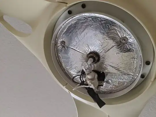

I have this ceiling fan in my house. The previous owner didn't leave any documentation about it. It came with a remote, but unfortunately the remote's screen does not turn on, even with a fresh battery.
The fan:fan
Here is the fan with the upper cover removed: under upper cover
Here is a close-up underneath the upper cover. This is the writing I can find on here. The other side looks roughly the same, but without any writing on it. under upper cover - closeup
Here is the fan with the lamp cover removed: under lamp cover
Here is a close-up underneath the lamp cover: under lamp cover - closeup
Here is the remote that came with it. Unfortunately, even with a fresh battery, the screen on the remote does not turn on. remote control front remote control back - with battery remote control back - without battery
Thanks in advance for your help! If we can figure out what kind of fan this is, I will try buying a new remote and see if that gets the fan going again.
solvingPuzzles
  • 145
    google the fcc number – jsotola Jul 05 '20 at 22:52
    @jsotola Done. Here's what I've learned so far. (1) [It's a 304 MHz remote.](https://fccid.io/FO8UC7091T) (2) There are lots of ceiling-fan-related products with the numbers UC70XX. I am looking for a compatible remote now. – solvingPuzzles Jul 05 '20 at 22:54
    home depot shows replacement remote controls ... would not hurt to try one – jsotola Jul 05 '20 at 22:56
  • @jsotola Good point. I am having trouble finding a remote that claims to be compatible with UC7091T. There are many replacement remotes for UC7078T and UC7081T. So, I think I will order a kit that contains a remote and a new receiver. If the remote doesn't work with my receiver, I will also install the new receiver. – solvingPuzzles Jul 05 '20 at 23:05
  • have you looked closely at the fan assembly? ... there may be a label ... the blades may have a part number on them ... look on top side of the blades ... it is quite possible that the remote control does not belong with the fan – jsotola Jul 06 '20 at 02:42
If the fan itself still works you should be able to get an aftermarket remote control package that includes a new remote and receiver/controller and you can just swap out both of them for the new ones. Fan brand shouldn't matter.
